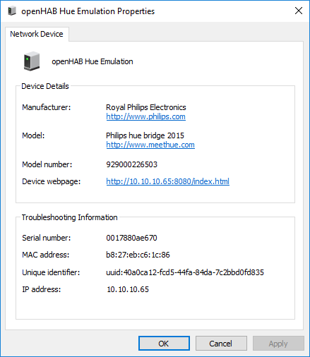

I have Hue Emulation installed, and I have set Discovery to TRUE. I also have, using the REST API, tagged my lamp Item as Lighting. From Windows Network Explorer, I can see the emulator showing up:
I was expecting to see the emulator appear as a Thing, but I only can find it on the Services page. Philips Hue apps on my phone are unable to find the emulator.
