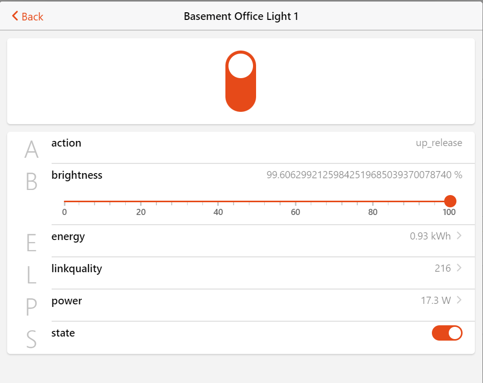

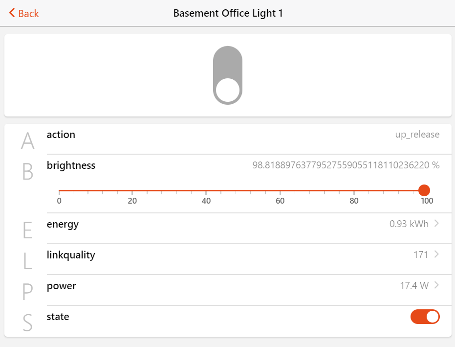

I’ve been trying to model my home using Equipment with little success. Most of my wall switches are also dimmable, and some also report power back – using a mixture of Inovelli Red (zwave) and Blue (zigbee) switches.
Here is what the equipment looks like :
The problem is, no matter what mix of aggregation I choose for the equipment group, I cannot get the equipment-level on/off to work correctly. Each individual item works correctly but the overall equipment does not. When I click off at the group level, all items receive the OFF command (including brightness), which immediately turns also turns the state on but leaves the group in the “off” state.
Turning the “Equipment” back on does nothing – in fact, if I manually turn state off and then turn the Equipment on, still nothing – and no message in the logs to indicate that “ON” is being sent to all items.
Am I trying to do something that is outside the use-case for equipment in the semantic model, or is there a better way to model this?

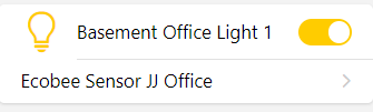

Here is what I have –
This works, but I would like the ability to perform the popup group details action if the widget is clicked on outside of the toggle that performs on/off (or, alternatively, a separate button on the widget that would pop up group details). Thoughts on how to achieve this?
Thank you again!
This doesn’t look like it’s possible. There is no way to add an additional action to a toggle widget. To achieve this you’ll have to create a composite widget that includes two controls, one for the toggle and the other for the pop-up.
Here’s a thread that gives you an example framework to start from.
Justin & Rich – thank you so much for your help. I pretty much have what I was initially after.

The widget above gives me this:
The toggle button works, as does clicking on the label to bring up the group popup. The only thing at this point is that I have to manually set the title to something more friendly (“Basement Office Light 1”) as I could not find a way to use anything like “popupitem.label” to get the display name – is the name/label of the item accessible in the widget?
