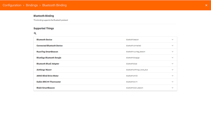

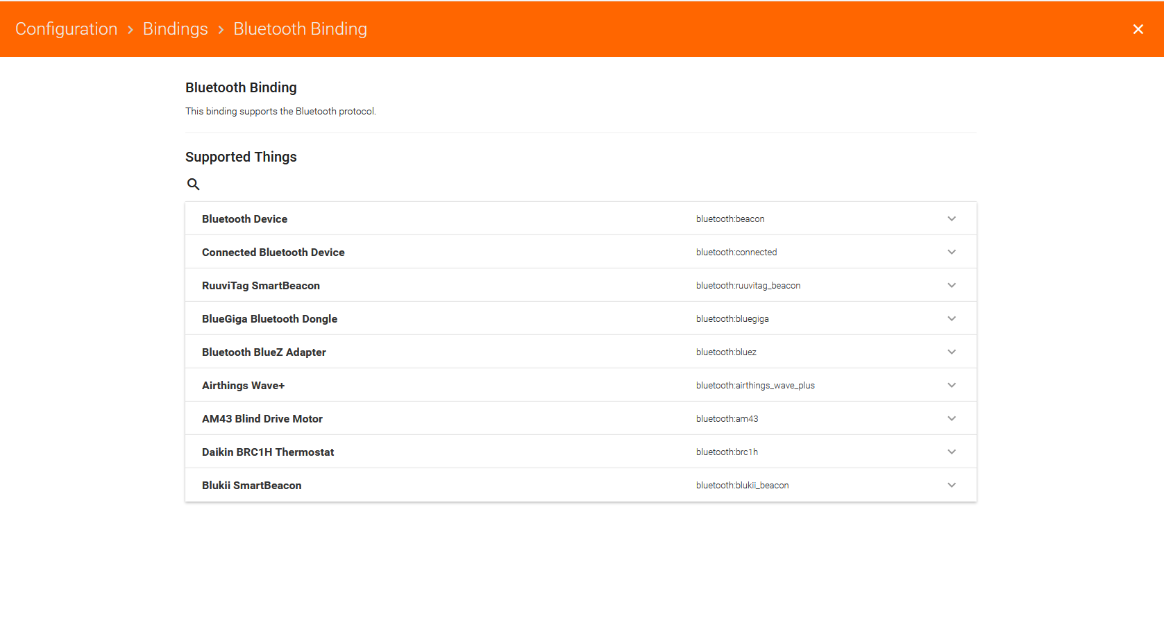

I saw some pictures where the Bluetoothbinding can be configured and Services and Characteristics can be configured in XML files.
But for me the only thing I can do is the following:
