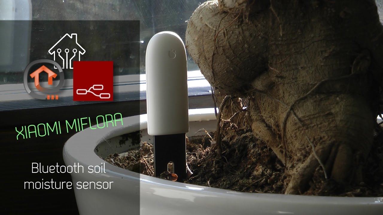

Hi All,
I know somebody started a similar topic already, but it seems to be unfinished. Let me give you my take on this device and how I did it on Raspberry PI 3. @Seaside has posted another approach, please scroll down to post 5 for that.
If you prefer to watch instead of reading, you can also watch my Youtube video on the same:
I took the basics from this website: projects:xiaomi-flora [Warszawski Hackerspace]
The important takeaway is that Xiaomi can update the firmware on Miflora over the mobile app and they changed how BT communication works in the past. So the below code currently works with firmware 2.6.6. I uninstalled the app from my phone, just to make sure the device is not getting updated again.
