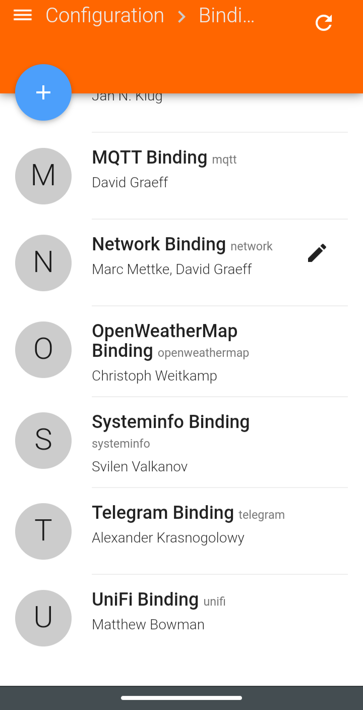

I’m not sure that’s true. Here’s my list from paperUI:
I manually installed the Unifi binding (i.e. jar file in add-ons folder). I remember when playing with Broadlink binding snapshots they also appeared in paperUI, and discovery and the rest of that shenanigans also worked.
