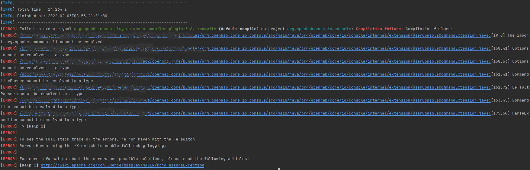

Here there is the error displayed:
And also when I’m trying to put the dependency like above explain in maven repository
<!-- https://mvnrepository.com/artifact/p2.osgi.bundle/org.apache.commons.cli -->
<dependency> <groupId>p2.osgi.bundle</groupId> <artifactId>org.apache.commons.cli</artifactId> <version>1.0.0.v20080604-1500</version> </dependency>
The p2.osgi.bundle, org.apache.commons.cli and 1.0.0.v20080604-1500 are in red and these names are not find by the IDE.
Do you see the problem?

Would this work instead https://mvnrepository.com/artifact/commons-cli/commons cli
Yes it works with this maven repository.
