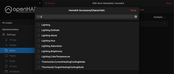

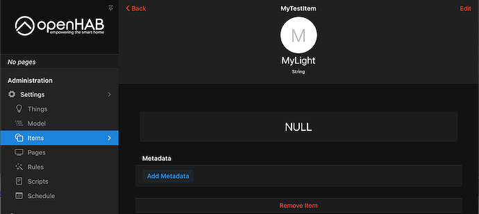

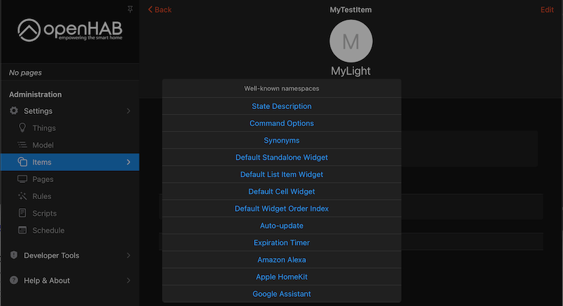

Today I tryed to add HomeKit but i strugel with. How con I assign a item using GUI to Homekit (as I don’t have any text-file for Items).
Perfect. Thanks. Do I have to reboot anything or should the item apear in homekit as soon as I add the meta-data like in OH2. Because I can only see OPENHAB 3 (marked with “not supported”), but no items in homekit.
there was a small issue in OH3.0 release with metadata - changes in metadata have not triggered a homekit refresh. it is fixed in the snapshot version but not in the official release. so, you would probably need to restart

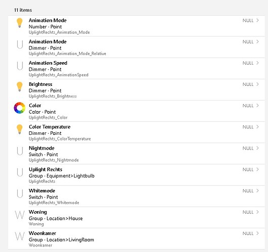

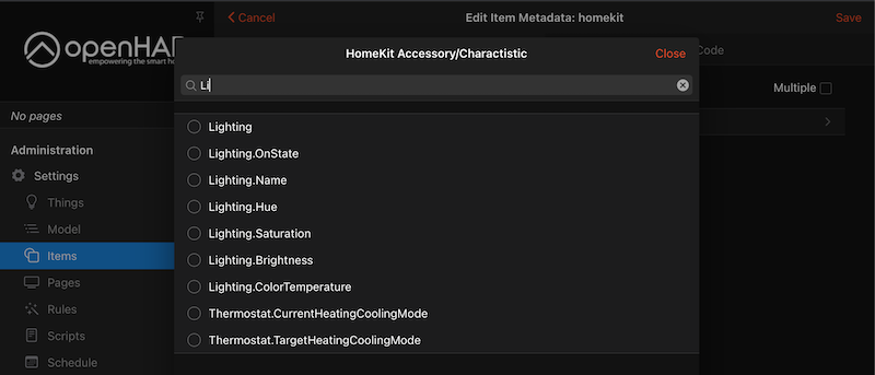

I added items via the GUI…tried different ones. Brightness and also color.
Should I do more configuration than just selecting the characteristic in the GUI for adding metadata?
Metadata not added for color temperature, but should I delete color temperature from the item? I selected all possibilities when adding items as equipment

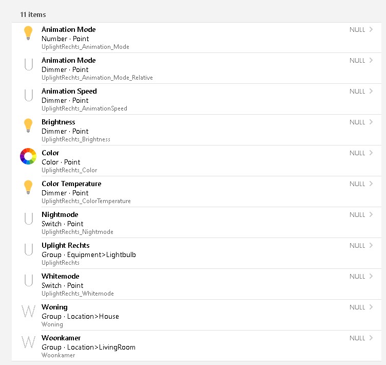

it looks like “Uplight rechts” is a group created from the semantic model, correct? I dont think this will work.

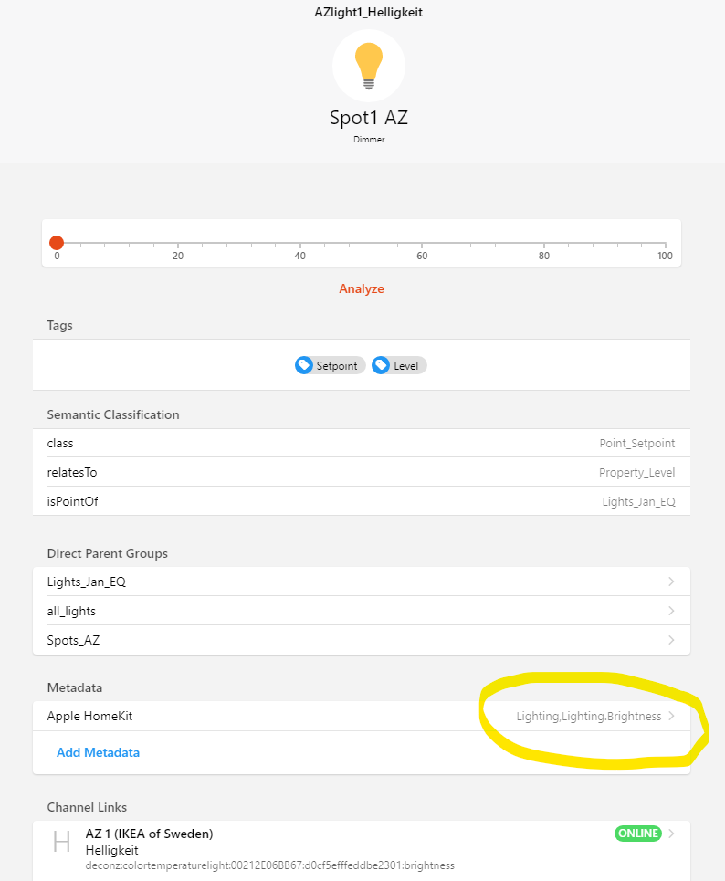

just use your Dimmer point item Brightness in the first place.
My Dimmer works with adding the two metadata tags “Lightning, Lightning.Brightness”. Maybe try that combination. If you correctly have installed the homekit binding and you see the openHAB bridge in your homekit, there is no need to restart. The bulb should be visible in a matter of seconds. I am using the EVE app to administer the items in homekit. Is a bit better overview. The lightbulb and bridge will show up in the “STANDARDRAUM” ( German )

Sorry for the late reply…didn’t have the time to try things out. Indeed the semantic issue you raised seemed to be the problem. It’s working now!! Many thanks!!

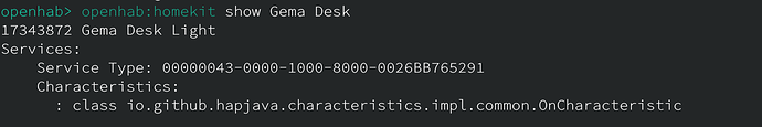

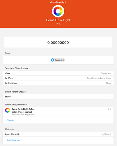

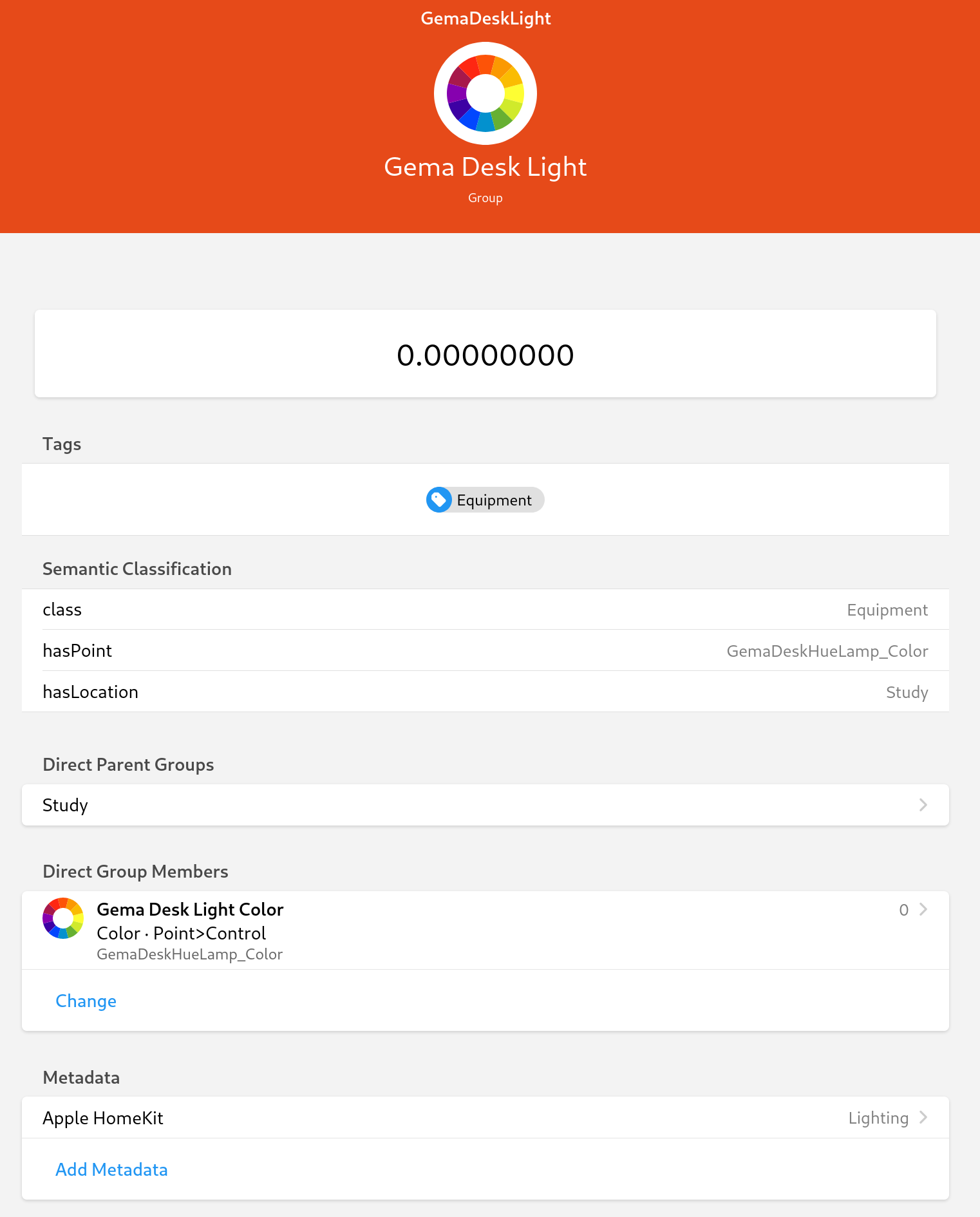

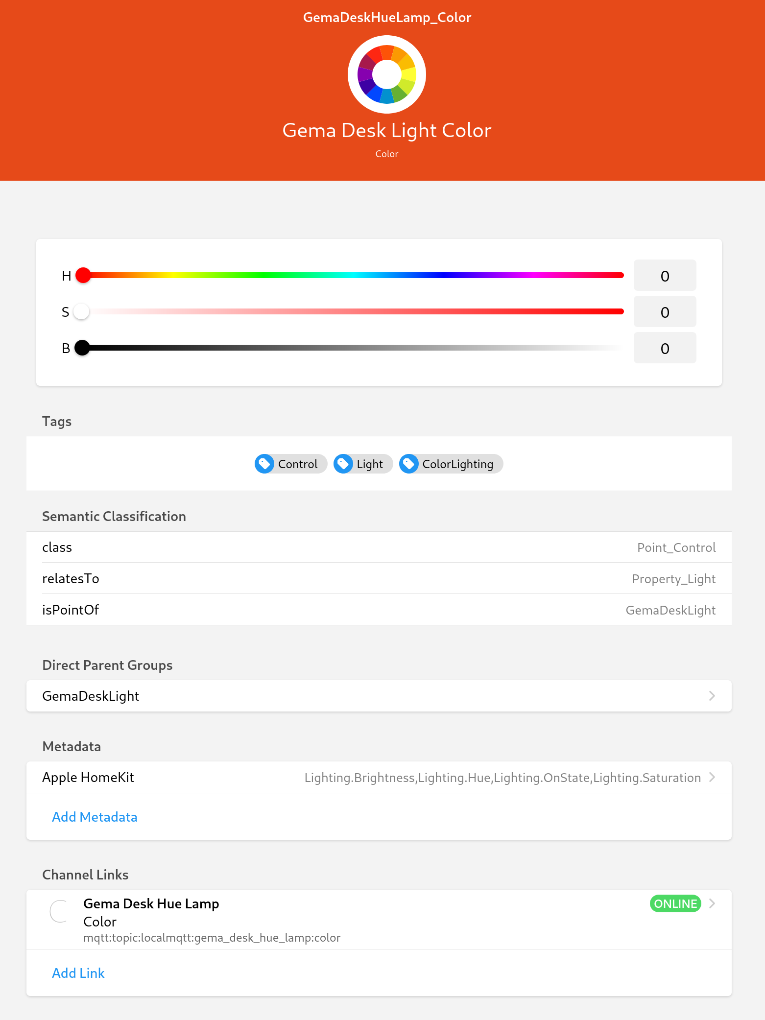

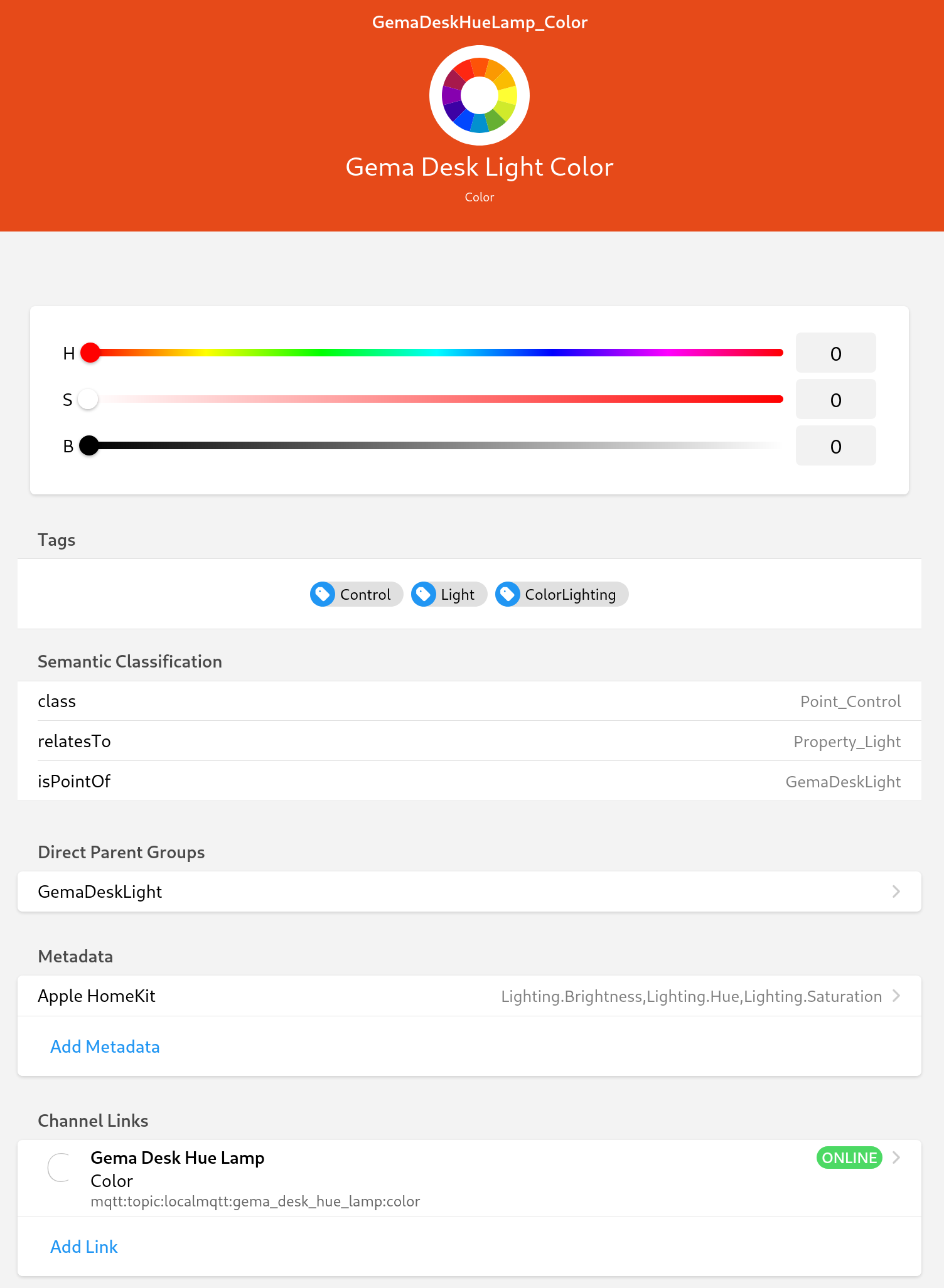

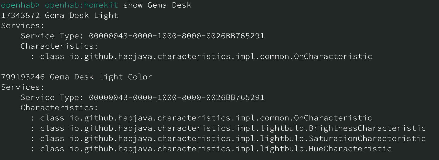

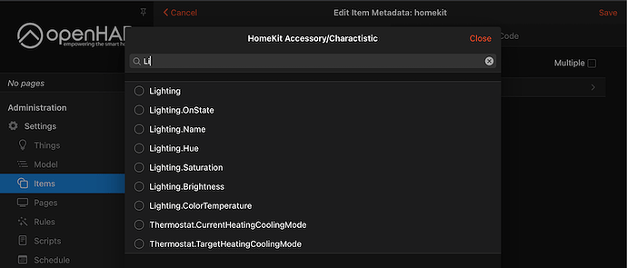

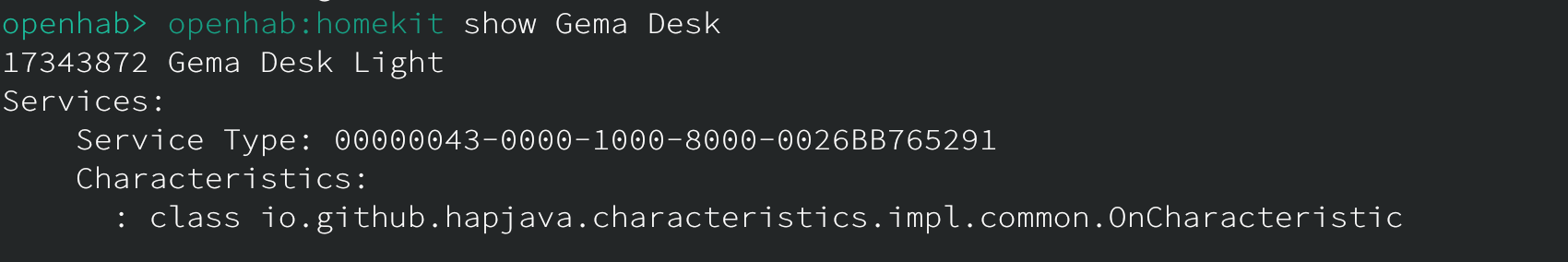

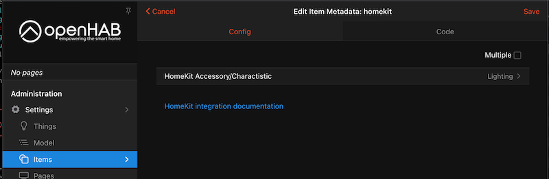

That’s what I believe GJW was trying to do, and so am I - I have an “Equipment” group for a light and I’ve added the “Lighting” homekit metadata to it. The colour control is an item/Point in that group, and it has homekit metadata “Lighting.Saturation”, “Lighting.Hue” and “Lighting.Brightness”. That results in a single thing being exposed on homekit that however only has an OnCharacteristic - the item is ignored, and only the metadata on the group is honoured/exposed. That seems counter to what the documentation describes?
If I also add “Lighting.OnState” to the item under the group, then both the group and the item get exposed separately, which is also not what I’m looking for.
the way how you and GJW are describing your configuration, sounds correct to me. The accessory type metadata must be at group, e.g. lighting, the characteristics meta data at items of that group. so, exactly how you describe it.
based on behaviour you see in home apps, it looks like items are not linked to the group and group has no homekit metadata.
can you describe exact steps you do, or maybe screenshots, so that i can reproduce the setup locally on my machine?
