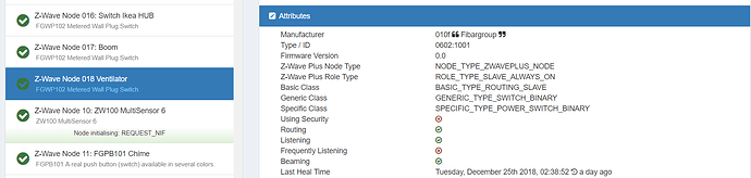

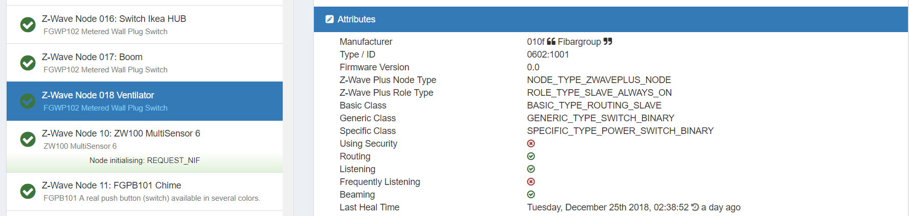

Resurrecting this thread as it may still be relevant.
On
2.5.0-SNAPSHOT Build #1472
openhab> list -s |grep -i zw
238 │ Active   │  80 │ 2.5.0.201812242048     │ org.openhab.binding.zwave
I removed node 018 more than 2 days ago. (on the 23. Remove=just unplugged the Wall-plug)
Have restarted/upgraded with node removed.
It still registers as Online and receives a Healed time even though it’s not there.
Is this expected behaviour?
@chris, any thoughts on this?
Not really - it doesn’t sound right, but it’s hard to comment without more information (ie logs).
My guess though is the controller still thinks the device is connected to the network - otherwise the binding would not know about the node at all. Clearly it should not be online though
