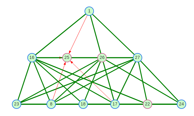

This is my network, 24 is the problematic one
The attributes of 24 says 6 neighbors (8, 17, 18, 23, 26, 27).
