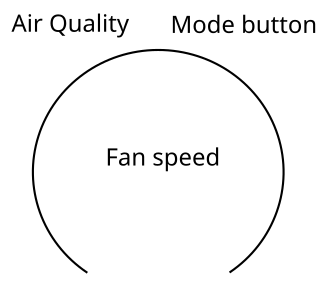

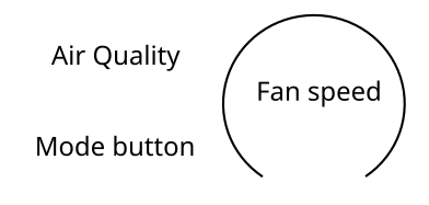

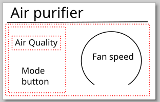

Question #2 about how I want to arrange these pieces can often be addressed by making some quick sketches or mock-ups to get an idea. I know the Content and the oh-button are small and text-shaped (rectangular). The oh-knob takes up more of a square space. Let’s look at some options:
There’s no right answer here, all would work. Personally, however, I like option 2 the best. It keeps the two interactive elements (the button and the knob) spaced out a little to prevent clumsy me accidentally pressing one or the other. I also just find the horizontal layout a little cleaner.

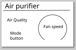

For my widget then I need to see if I can articulate how the layout I sketched fits the three main f7 layout components:
  1. I explicitly defined “Air quality” as content to go in some block of text: this will now clearly be an f7-block
  2. I want that f7-block to be in a column with the mode button
  3. I want that two part column to be in a row with with knob
  4. I want that overall row to be in the content area of a card
We could do the same logic visually by drawing the structure we want right on our mock up:
In both cases what we can see here is that there’s no reason to over-complicate the structure. One of the reasons that UI library like F7 exist is that it can get pretty easy to get lost in the weeds of element position and spacing when building a web page. The f7 components are specifically designed to handle a lot of that work for you so it’s best to just let them do their job. There’s a very good chance this won’t be 100% perfect on the first try, but it’s going to be very close and will mostly like require minimal manual tweaking.

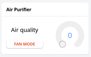

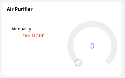

And this is the result:
Yeah, by keeping it simple we got pretty close!

I see only a few things I want to tweak to get it closer to my original idea:
  1. I want the button to be a little more obviously a button.
  2. The knob is a little too big relative to everything else.
  3. The “Air quality” text needs to be a little bigger, centered over the button.
  4. The button and the text need a little more space between them.

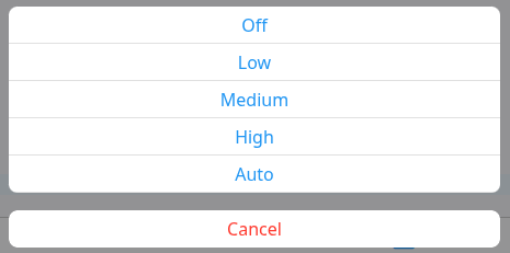

The oh-button is an example of the second kind of interaction, the widget actions. In fact, these two are so closely linked, that the main reference information for the widget actions is part of the oh-button component reference page. When you look at those examples you see that the pattern is always the same; configuring an action requires setting the action property to the type of action you want and then configuring some number of additional properties that vary depending on the type of action. My fan mode item as described above is a series of options, so the action that makes the most sense here is the options action. Opening up the example on the actions reference page, I see that the options action will need actionItem and (optionally) actionOptions properties. Those are all separate config options so that looks like this for my button:
- component: oh-button
    raised: true
    text: Fan mode
    action: options
    actionItem: Filter_MasterBedroom_FanMode
    actionOptions: 0=Off,1=Low,2=Medium,3=High,5=Auto
Now, when I press the button my widget presents me with a pre-formatted list of options which will send the associated command to my fan mode Item.

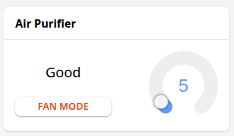

The third kind of interaction, the widget expression, is required for the “Air quality” indicator (which at the moment is just static text). This is not the place to go over all the many things that widget expressions can do; there’s a comprehensive doc page for that. For now, I’m just going to focus on the most fundamental thing that a widget expression can do: give you access to some basic information about an Item.
All widget expressions begin with = and include syntax that parallels javascript. Right now you don’t have to know any javascript at all, because we’re just going to use an OH specific shortcut that always gives the State of the Item formatted how you’ve defined it in the Item’s state description metadata: @'Filter_MasterBedroom_AirQuality' (you can look in the link above to see exactly what this shortcut is doing).
Here’s the current state of the widget with the components all connected properly to OH.

But how do I use a widget expression to select a different color for each value of my air quality Item? This sounds like an advanced expression, but fortunately the OH expression doc page has a perfect example that I can adapt easily under the objects section. I just need to pick 6 different color names, and use them and the air quality text options to build a object in the expression and then reference the object with the current state of my air quality item.
- component: f7-block
    style:
      font-size: 20px
      text-align: center
      margin-bottom: 20px
      color: =({'Extremely Poor':'FireBrick','Very Poor':'DarkOrange',Poor:'Gold',Moderate:'YellowGreen',Fair:'GreenYellow',Good:'ForestGreen'})[@'Fitler_MasterBedroom_AirQuality'] || 'Black'
    default:
      - component: Content
          text: =@'Filter_MasterBedroom_AirQuality'
GoodModerateExtremely Poor
I think that makes this widget complete! Thank you for reading this far. There’s plenty more to learn, if you are interested…
