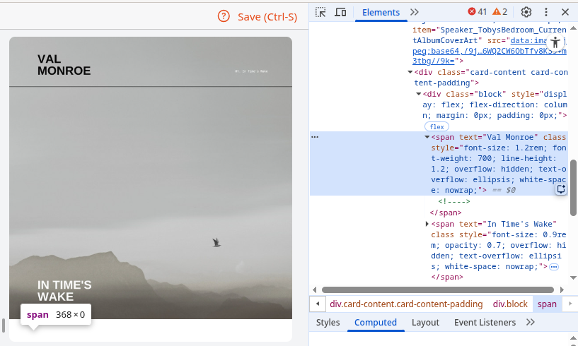

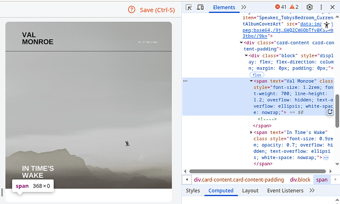

The first thing to check, of course, is where in the widget these text items are being rendered, and that’s pretty easy: it’s the two span components at the very end of the widget. We know what doesn’t work, now we just have to figure out why.
The inspector
Nine times out of ten, the first tool that I’m going to reach for when widget troubleshooting is the browser’s page inspector. This tool opens up a panel full of useful development and troubleshooting tools and allows you to quickly target the specific area of a page where you think the problem is. In this case, it’s pretty clear that my problem is in the white area below the image. So, I’m going to right click on that white area specifically and select the inspect option at the bottom of the context menu.
:memo: Browsers
I use mostly Chromium-based broswers, so all the examples will use Chrome’s terminology and short-cuts. I occasionally use FireFox (especially when testing if a problem is restricted to Chromium or not) and know that these features are all pretty much identical in that browser. I cannot say what terms or specific functions are the equivalents in other broswers, but I would guess most of what I’m discussing in this tutorial is pretty well standardized.
The panel that opens when I inspect that white space shows the html of each element on the page and highlights the element I last interacted with. In this case, however, it thinks the last element I interacted with (where I right clicked) is the base card element, and I have to expand that two levels before I see the span elements I’m looking for. Hovering over the first span element HTML will then highlight that element on the page and show an overlay with the element’s dimensions.
In this case, my span element is 368 pixels wide and 0 pixels tall (0 pixels tall, incidentally is why I couldn’t right click on the span and wound up clicking on the card background instead). An element can really only be 0 pixels tall under two circumstances: 1) CSS setting it 0 pixels, or 2) The height is automatically calculated and there is just no content inside the element. Looking at the expanded span HTML in the panel we can see that in this case it is the second option. <!-- opens an HTML comment and --> closes it. So, in this case <!----> is just an empty HTML comment. There is no text inside the span only a comment which renders to nothing.

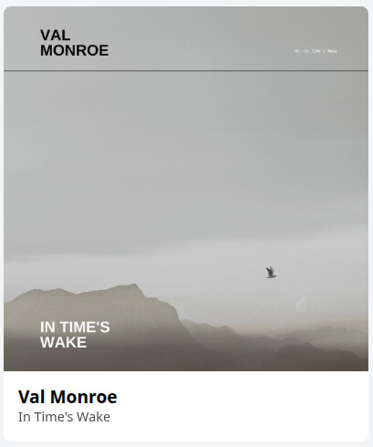

The item state that we have linked to this element in the widget YAML is clearly functioning because we can see that the span has a text attribute with the correct string value. Why didn’t the string in the text config become text inside the span element? Checking the doc page that introduces HTML components, we see that the correct configuration for setting text content in an HTML components is content not text. This is a case of component mis-configuration. All we have to do is change:
text: =items[props.artistName].displayState || items[props.artistName].state
to
content: =items[props.artistName].displayState || items[props.artistName].state
(and do the same for the second span as well) and now our widget functions as expected.

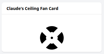

There’s some intimidating looking text at the end of this, but let’s see if it works (spoiler alert…it doesn’t).
Not bad. Claude got the widget parameters correct, I can set the item and the title. It seems that the big ugly block of text at the bottom is a custom made ceiling fan SVG graphic; we can work with that for now. There’s a pretty big issue, however: when I click on the card nothing happens.
Because there is only one thing that should happen (and therefore only one configured action for the widget) we can at least locate the source of the error pretty quickly:

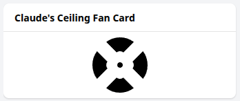

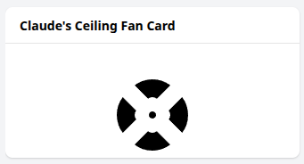

And now…clicking on the card still does not do anything.
Looking again, I see there’s a second very common mistake:
component: f7-card
The action configurations are specific to the oh- family of components. Nothing is happening because the f7-card completely ignores the action. There is an oh-card which is based on the f7-card and the oh-card does allow for actions so I just have to change the component:
component: oh-card
  title: =props.title
  style:
    cursor: pointer
  action: toggle
  actionItem: =props.fanItem
  actionCommand: ON
  actionCommandAlt: OFF

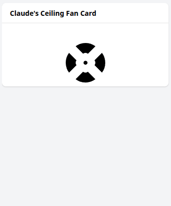

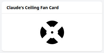

Uh oh! When I change from the f7 to the oh based card, the fan icon in the main section of the card disappears:
ts_fan2
The only reason I can think of that would explain why the components inside the card just changed is if the f7-card and the oh-card use different slots. Back to the component reference pages. The oh-card page says:
Slots
You need to define either one of these two slots:
  • content: The default slot for content, which will then be rendered inside a f7-card-content element.
  • content-root: The slot for content that should be rendered directly inside the card, without any additional wrapping element. If this slot is defined, the content slot will be ignored, and you have to implement the handling of config.contentStyle and config.contentClass yourself.
It looks like the default slot that works with the f7-card does not work with the oh-card so I need to update that as well. When I change the slot name to content I see the complete fan card, and it even works:
ts_fan3

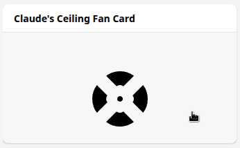

Not only does the widget control my fan, but the animation does show a spinning icon. Drat! I was hoping Claude would mess up the CSS animation and we could work on debugging that, but that animation looks pretty good. It’s not how I would have done it and it’s “thought” process for how it arrived at this solution was not 100% correct. It’s doesn’t seem to know about the stylesheet configuration option which is not surprising as that is not well documented still and so not likely in the model’s training data. This does highlight one weak point in using LLM’s like this, but if it works it’s good enough for now.
I could consider this done now and use it as is, but I’m not 100% satisfied still. There’s a lot of extra blank space above the fan icon that I’d like to eliminate.

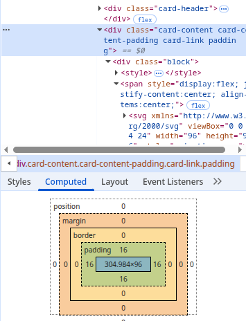

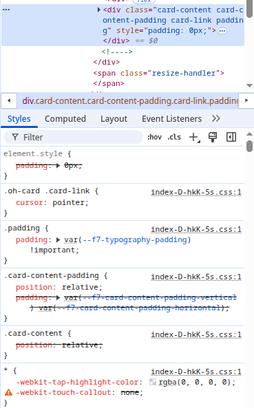

When trying to track down position and spacing issues, again the very first thing I’m going to do is to open up the element inspector and look at the resultant HTML to see if I can spot anything strange there. Here’s the HTML for the elements on the card:
<div class="card oh-card" style="cursor: pointer;">
  <div class="card-header">
    <div>Claude's Ceiling Fan Card</div>
  </div>
  <div class="card-content card-content-padding card-link padding">
    <div class="card-content card-content-padding" style="display: flex; justify-content: center; align-items: center; padding: 16px;">
      <div class="block">
        <style>
          @keyframes fan-spin { from { transform: rotate(0deg); } to { transform: rotate(360deg); } }
        </style>
        <span style="display:flex; justify-content:center; align-items:center;">
          <svg xmlns="http://www.w3.org/2000/svg" viewBox="0 0 24 24" width="96" height="96" style="animation:none">
            <path fill="currentColor" d="M12 11C11.45 11 11 11.45 11 12S11.45 13 12 13 13 12.55 13 12 12.55 11 12 11M12 2C10.07 2 8.35 2.62 7 3.67L10.77 7.44C11.14 7.17 11.55 7 12 7S12.86 7.17 13.23
  7.44L17 3.67C15.65 2.62 13.93 2 12 2M2 12C2 13.93 2.62 15.65 3.67 17L7.44
  13.23C7.17 12.86 7 12.45 7 12S7.17 11.14 7.44 10.77L3.67 7C2.62 8.35 2 10.07 2 12M22 12C22 10.07 21.38 8.35 20.33 7L16.56 10.77C16.83 11.14 17 11.55 17 12S16.83 12.86 16.56 13.23L20.33 17C21.38 15.65 22 13.93 22 12M12 17C11.55 17 11.14 16.83 10.77 16.56L7 20.33C8.35 21.38 10.07 22 12 22S15.65 21.38 17 20.33L13.23 16.56C12.86 16.83 12.45 17 12 17Z">
            </path>
          </svg>
        </span>
      </div>
    </div>
  </div>
</div>
Again, we don’t need to understand every level of that HTML. In the previous tutorials, I’ve mentioned that every container element (elements that just hold some other element without any direct content of their own) should be simple, explainable, and not redundant. Here’s a great example.
There are two div elements that have a class which indicates that element holds the card’s content (card-content). Where do these come from? The style directive on the second one matches the style object on the f7-card-content in the widget code so that’s one that I have explicitly put there. To figure out where the first one came from, I have to go back to the oh-card docs. The answer is in the quote from the docs above:
When Claude created the widget, the f7-card root component needed an f7-card-content child component, but when I switched to the oh-card it seems that the content component is added automatically, behind the scenes. Let’s remove the second card content component and see if that fixes the spacing issue:
That’s better, but still not right. There is much less extra space around the card icon, but there’s still some extra space above it and as a result it’s not centered in the card content area. To find where that last bit of empty space is coming from, I’m going to use another feature of the browser’s inspector.
At the top of the browser panel that opens for the developer’s tools, there’s a small button that looks like this: ts_inspect_button. When you press that button and move the cursor around the displayed page, every element you hover over will get an overlay showing information about the element including its padding and margins.
ts_fan5
Another way to see the same information is to click on the text of each element in the elements panel; the size and spacing information will be displayed on a graphic at the top of the lower “Computed” styles panel.
In the animation above, you can see that the card content element adds a reasonable space around everything in the content area in the form of a 16px padding (green highlight) on all sides. The next, element, the block element, however, then adds additional spacing, including a top margin (orange highlight) of 16px, and this results in the offset of the svg content. So, the problem is the f7-block.
Because of the way that Claude chose to build the widget using the f7-block’s innerHTML property we can’t get rid of the block without completely rebuilding the widget. Instead we’ll just have to remove the margin (and while we’re at it the padding just to be safe) from the block.
- component: f7-block
    style:
      margin: 0
      padding: 0
    innerHTML: >
That’s better yet, but it feels likes there’s still just a little too much space. Looking at the animation above, you can see that, actually there’s some space around the drawn areas built right into the icon. I probably don’t need any additional space from the containers because of the way the SVG is constructed. Let’s also remove the padding from the card content element. This content element, recall, is added automatically by the oh-card so there’s no component in the YAML that I can add a style to. Fortunately, the oh-card comes with special style properties. From the card docs:
Style
`oh-card` provides full control over the style of itself as well as the header, content and footer.
The card itself can be styled through the style and class config properties, while the header, content and footer can be styled through the headerStyle, headerClass, contentStyle, contentClass, footerStyle and footerClass properties.
So here I just need to use the contentStyle instead of the regular style property:
component: oh-card
  title: =props.title
  style:
    cursor: pointer
  action: toggle
  actionCommand: ON
  contentStyle:
    padding: 0
When I try that, nothing changes. What did I do wrong? To find out if I correctly applied the padding style, I’m going back to the browser inspector once again. I’m going to click on the card content element and flip over from the Computed lower panel to the Styles lower panel which should show me, in order of precedence, all the CSS styles applied to that element.
This can look a little overwhelming at first, but there’s a lot of helpful information here. For now, I’m just looking at all the hints related to “padding”. First off, the element text itself shows that I did properly declare 0 padding for this element: style="padding: 0px;". However, it also shows that when the oh-card creates the card content container it adds a padding class to the container.
Below that, in the list of styles I see my padding: 0px listed right at the top, but it’s crossed out. The next place that padding is shown explains why: the padding class adds a padding style with the !important CSS keyword. This keyword will prevent any other styles from overriding the “important” style. To override an “important” style another style declaration also has use the !important keyword.
So, to set the padding to 0 instead of padding: 0, I need to use padding: 0 !important to override the previous padding setting. When I do that, I get exactly what I’m looking for.

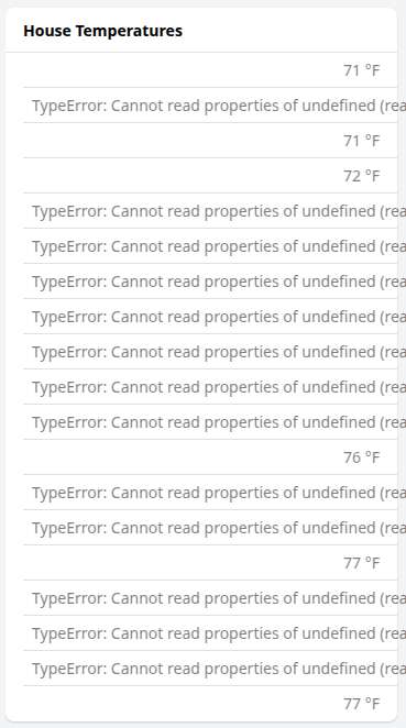

That configuration is pretty concise. There’s just one problem:
ts_temp1
It doesn’t work at all. None of the list items that I expect are visible.

The big clue here is I’m expecting 10 - 12 items in this list and there is a single, malformed div.
That tells me the problem lies with the repeater. A quick check of the repeater’s doc page and the problem is clear: the correct property name to list the tags is itemTags not just tags. So, changing the config to:
itemTags: Measurement,Temperature
Should get me my list:
…or at least a list.

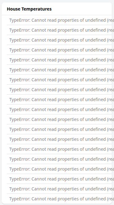

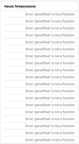

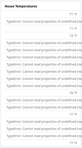

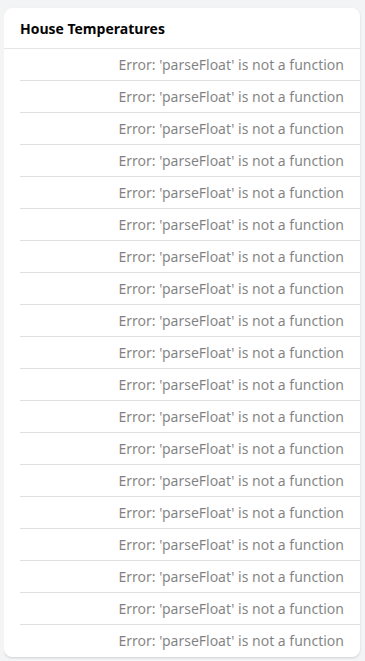

Well, I got my wish. There’s definitely an error in one of the expressions in this widget. This is a pretty easy one to start with because Error: 'parseFloat' is not a function is quite descriptive.
The error here is that you cannot call parseFloat() directly, it is a method of the javascript Number object, so it has to be Number.parseFloat(...) instead.

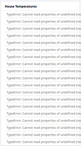

We’re making progress. The full error text which is cut off in the screenshot is TypeError: Cannot read properties of undefined (reading 'match').
This is a common javascript error. It means that instead of [object].match(...) some part of the expression evaluates to undefined.match(...) (and of, course there can’t be any methods or properties of something that is undefined). The problem must be here:
items[item].displayState.match(/[°a-zA-Z%]+/)
displayState should be a String (which does have a match method). items[...] is the correct way to access the item information.
That makes the problem [item], and although item is the correct repeater variable name it must be referenced via the loop object and we must pass the name String not the entire object to items.
It seems Claude made this mistake repeatedly, and I have several instances of items[item] that I have to change to items[loop.item.name].

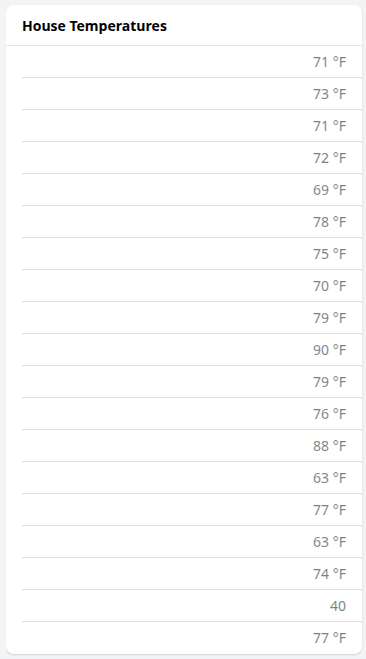

What? It seems that some instances of displayState work and others are undefined. Aha! Claude fell victim to one of the classic blunders!
MainUI will save bandwidth by sending only the state of an item if the state and the displayState are equal. You should almost never just rely on the displayState for exactly this reason, and most widgets use an expression that will return the displayState but fall back to the state if required. In fact, this is such a common requirement, that there’s a shortcut for this behavior @itemName.
So, in the after expression I need to change both the displayState references to use the @ shortcut:
after: =Math.round(Number.parseFloat(@loop.item.name)) + ' ' + ((@loop.item.name).match(/[°a-zA-Z%]+/) || [''])[0]

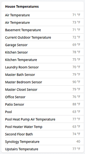

And with that, all my nice round temperatures are available.

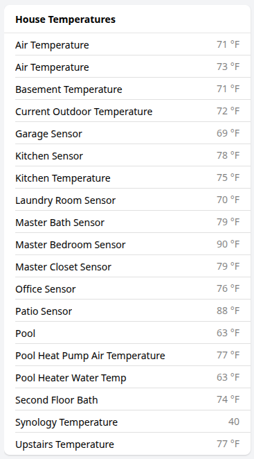

Still can’t see which items those are though…alright, let’s look at the title expression. This one is short and sweet:
title: =items[loop.item.name].label
I know that items[loop.item.name] works because it worked in the after expression (before I upgraded to the shortcut). So the problem must be the .label. This is an excellent chance to use the expression tester.

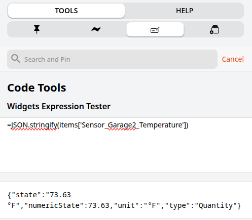

In the developer tools side panel (shift + alt + d) the third tool is the widget expression tester. You can put an expression (with the leading =) in the top box and see the output in the bottom box.
Now, the tester does not have access to the current widget context (even if the widget editor is open) so we can’t use the loop.item variable, but we can just replace that with one of the item names we know it is using. If we put =items["Sensor_Garage2_Temperature"] in the top box, the bottom just says [object object] which is the standard javascript output for an object, and not very helpful here. If we want that in more readable terms we have to “stringify” it:
and when we do that, we see that the items object just doesn’t return the item’s label. For the bandwidth reason mentioned above, the items object is very restricted in its information and items[...].label will never work. Fortunately, because this is the child of a repeater, the loop.item variable is a complete object for the item including the label. So we can just change the expression to title: =loop.item.label.

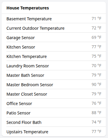

Now that I can see what the items in the list are, it is clear that the repeater is not properly filtering the output list. I can see several “Air” and “Pool” items and the temp of my Synology drive (without it’s °C, for some reason I’ll have to look into later). Claude made the filter expression a pretty standard sequence of boolean tests (in YAML > is just an indicator of a multi-line string, so everything that follows is the same expression):
filter: >
=!items[loop.item.name].label.includes('Pool') &&
!items[loop.item.name].label.includes('Outside') &&
!items[loop.item.name].label.includes('Air') &&
!items[loop.item.name].label.includes('Synology')
Well, right away I see the same label issue as above, so all those need to be changed to just loop.item.label. But that doesn’t actually fix the problem.
The rest looks correct to me so it’s time to go back to the repeater’s doc page:
filter Filter expression TEXT
Specify an expression WITHOUT THE = PREFIX to filter the resulting array
There’s the problem in big capital letters: Claude added the = to the front of the filter value. There’s a good technical reason for this requirement, but for now we can just accept that the = needs to go. When it does, the widget is complete and correct:
