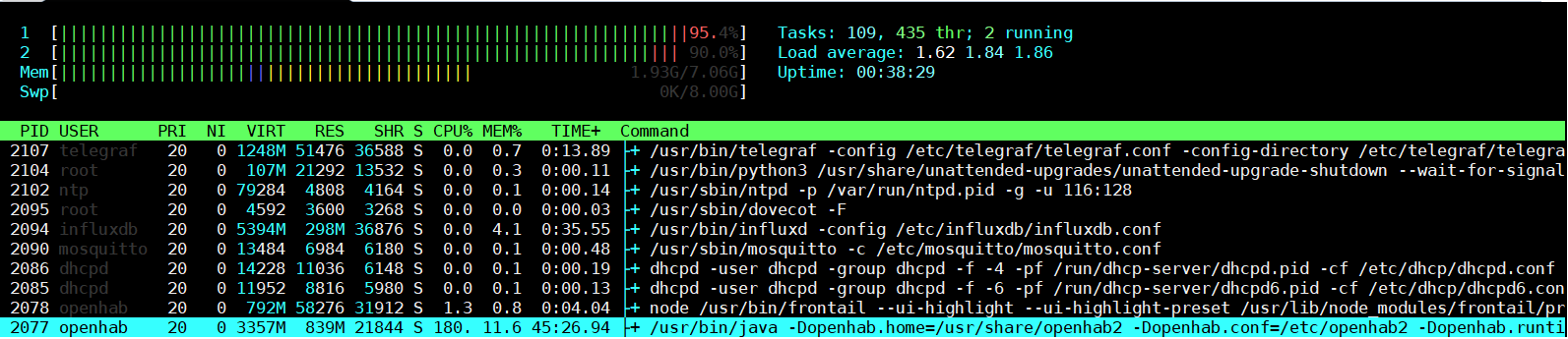

Here a screenshot of htop after 40 mins uptime:

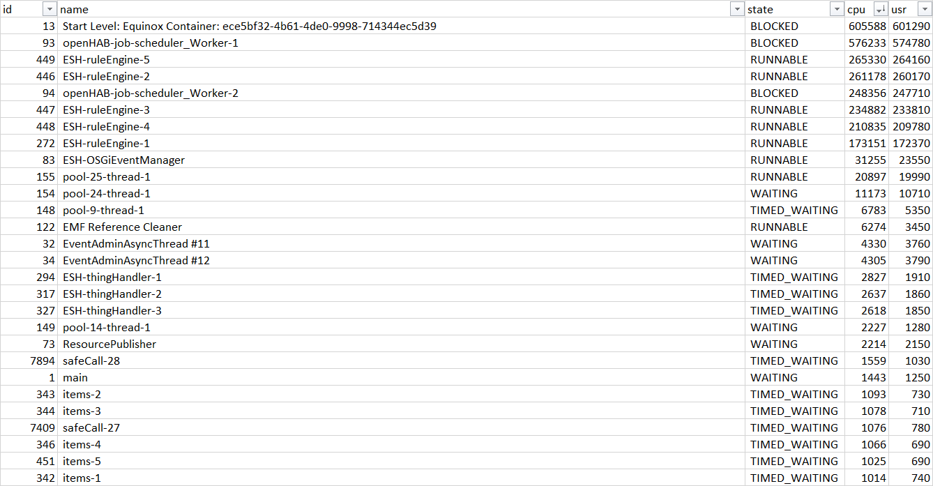

Here a list of threads --list from karaf
