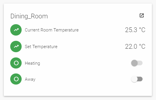

What I mean is shown in the picture below.
  1. the thermostat turns on the heating when the room temperature is below the set temperature; its state is determined solely by the functionality inside the thermostat, and it cannot (shall not) be changed by OpenHAB; it is marked in the XML as Read-Only, and so it appears in PaperUI grayed out, and its position cannot be moved by the mouse; but the position of the switch moves left to right depending on the thermostat’s actual state.
  2. by contrast the Away switch is used to inform the thermostat that the user is leaving the house, so that the thermostat can switch to an energy saving mode; therefore this switch must be adjustable by the user; it is marked in the XML as NOT Read-Only, and so it appears in PaperUI not grayed, and it is possible for the user to move the switch with the mouse; also if the user switches to Away mode by touching the physical thermostat, the Switch will also move to reflect the actual status..

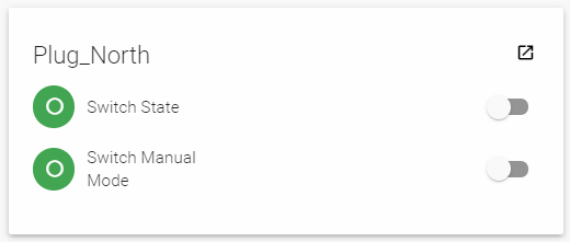

My question relates to another device from the same supplier (a smart plug) – see second image. In this device there are basically two Switches. One switch (Manual Mode) determines if the plug is being controlled automatically by its own internal program (Auto mode) or can be controlled manually by external user commands (Manual mode). If the plug is in Manual mode, then the other switch (Switch State) allows the OpenHAB user to turn the plug on or off. The Switch State cannot be manually adjusted if the device is in Auto mode, so the Switch State switch must be grayed out, if the Manual Mode switch is not turned on.
Pretty sure what you want is the DynamicStateDescriptionProvider where you can change the readonly attribute on an existing channel. Works fine but be aware that the paperui only sees the change on a reload (will not see the change dynamically as you make it)

The way a user will actually use this is by linking the Switch State and Switch Manual Mode to Switch Items. Switch Items can always receive a command. And if you make it so that when Switch Manual Mode is ON that the ON commands sent to Switch State are silently ignored then users are going to not be happy.
It may look nicer in PaperUI’s Control tab, but it will cause this binding to break the way Items like these are supposed to work, from the Item perspective. It violates expectations which is not a user friendly move to make.
