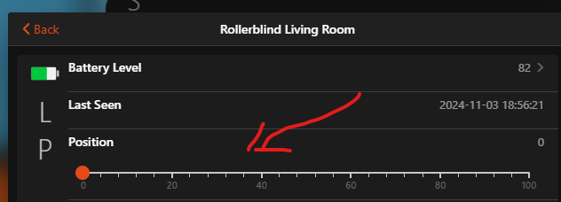

I have a very simple scenario:
When the window is open (contact sensor), then the slider of the roller shutter should be disabled (why? well it will unroll over the window and “kill it”)

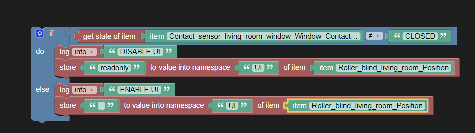

I was looking for a rule to update some metadata of items:
Generated code
var itemMetadata;
if (items.getItem('Contact_sensor_living_room_window_Window_Contact_State').state != 'CLOSED') {
  console.info('DISABLE UI');
  itemMetadata = items.metadata.getMetadata('Roller_blind_living_room_Position', 'UI');
  itemMetadata = (itemMetadata === null) ? { value: '', configuration: {} } : itemMetadata;
  itemMetadata.value = 'readonly';
  items.metadata.replaceMetadata('Roller_blind_living_room_Position', 'UI', itemMetadata.value, itemMetadata.configuration);
} else {
  console.info('ENABLE UI');
  itemMetadata.value = '';
However seems it doesn’t work as expected, the slider stays active.

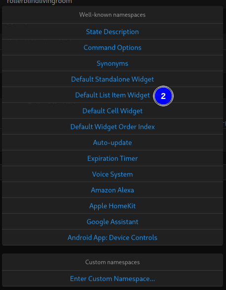

For any item you can define custom widgets that will be displayed as the default widget in auto-generated OH lists. This value is set in the item metadata under Default List Item Widget. In this case there is a very simple solution and you don’t even really need to create your own widget. You can use nearly all the default settings that are in place in that metadata. However, if you scroll down to the bottom of that page, there is a Visible field that takes a widget expression. The expression just needs to return a boolean result with true meaning the item will be visible and false meaning it will not. So in this case you want an expression based on the state of your window contact. Something like this:
=items.Contact_sensor_living_room_window_Window_Contact_State.state == 'CLOSED'
Hi @JustinG thank you for your help it works like a charm!
I share here the steps with some screenshots as it might help future readers (was not easy for me)
