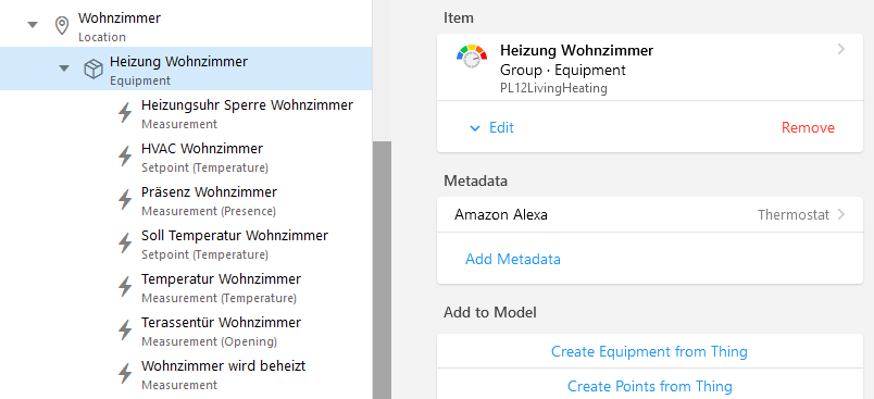

I use the UI to configure my OH3.3 and I got this:
The main Group-item is a “Equipment” and is configured as “Thermostat” with Alexa, the corresponding items for TargetTemperature, Mode and CurrentTemperature are listed:
But still, my Alexa App tells my “device does not respond”?
What did I miss here?
The configuration looks good assuming you defined your Thermostat supported mode properly.
Have you gone through the troubleshooting guide?
It might also be related to:
thanks, I didn’t check the HVAC mode-settings after moving my installation. HVAC mode was NULL!
