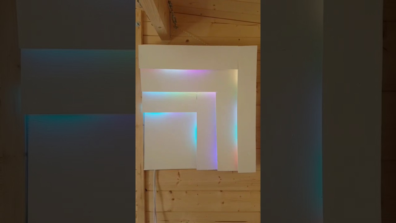

19 pixels built into this proof of concept for a client that wanted this around their front door.
22 pixels in this wall light assembly, OpenHab2 now controls it with a button event from Velbus starting and stopping a choice of DMX chases in OpenHab2.

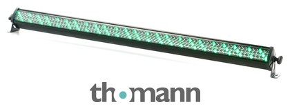

I have a client that has bought a pair of outdoor DMX / LED washlights, which will hang on a Art-NET to DMX adapter, which I’ll give him a colour picker and choice of chases with OpenHab2 :smile:
https://m.thomann.de/gb/showtec_led_light_bar_16.htm
