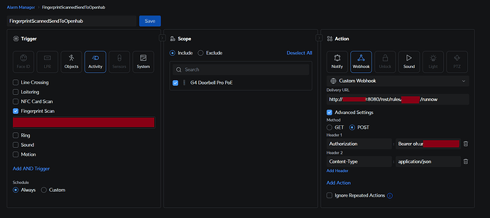

This works for me with the standard API:
I guess it is not useful if you can use regular post requests. The unifi Android app doesn’t appear to allow for plain text post. I guess I should have tried the web version first.
So annoying when Android does not receive the same support as iOS
I think the web version is also incomplete: I could never find a way to set a body there. But maybe this changed in a newer version.
But at least you could also set a header there. However a POST without a body is pretty pointless.
So with only Android phone/WWW page you cant change the content type to be able to use it without the additional binding? ( I can’t use it as my house since 7years is running on OH2.4, with general rule if it ain’t broke, don’t fix it)

Hi all, here are my 5 cents to connect Unifi Protect with OpenHAB. I wanted to connect G4 Doorbell Pro with KNX switch in OpenHAB which opens door lock. I was not successful with webhooks :confused: so I came up with my solution.
  1. create in OpenHAB API Key
  2. create any rule which will be triggered on “unused” item, and rule will contain only command to open door lock
  3. find this rule in <openhab_ip>:8080/developer/api-explorer in part with GET /rules. Find “uid” of the rule defined in step (2.) You should be able to find it based on the rule name. This “uid” is needed for final URL. example: http://<openhab_ip>:8080/rest/rules/“uid of the rule”/runnow
  4. setup a custom webhook which will run with API Key our rule, which will open door lock.
