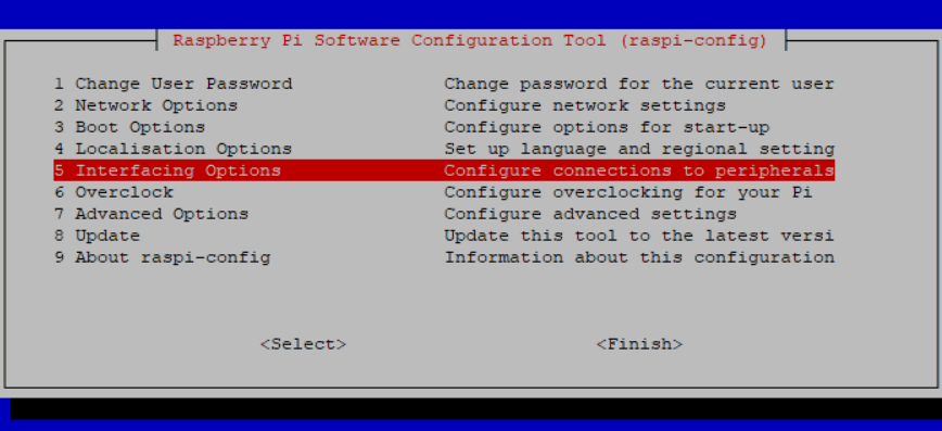

I made it on a Raspbian with using software configuration tool:
I can’t find such option on Openhabian.

You need to enable it with raspi-config.
Installing OpenHABian removes raspi-config. Perhaps there is a menu option in openhabian-config. I cannot check now.

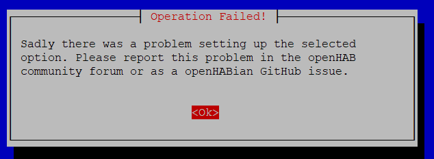

I checked menu option 28 and unfortunately i got an answer:
Paging @mstormi.
