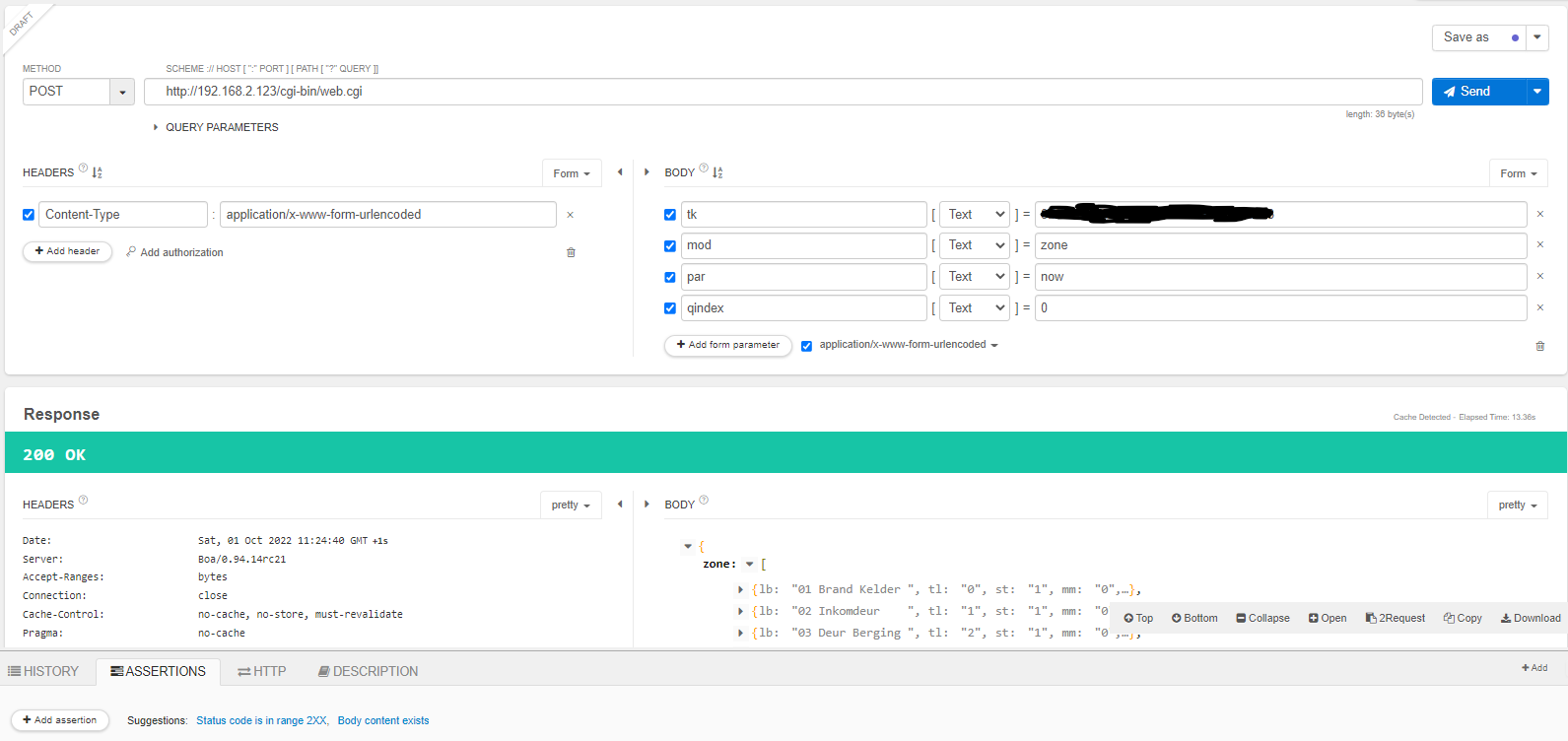

I have an INIM alarm system for which unfortunately there does not yet exist a binding. Nevertheless, there is an API interface possible through http POST. Unfortunately my knowledge about POST/GET and cURL and the likes is very limited, so hoping for some help here.
On the web I found that the alarm status can be read and written through http POST. There is a google chrome extension “Talented API tester” that I can use to test POST/GET commands. Via this method, I have succesfully been able to read and write the alarm status. Below a screenshot on how I do this:
So input as following:
Base URL: http://cgi-bin/web.cgi
Content-type: application/x-www-form-urlencoded
Body:
  • “tk”: my secret code, which i have blackened out
  • “mod”: zone or cmd or do_sce (depends on what I want to read or control from the alarm)
  • “par”: sce or now (depends on what I want to read or control from the alarm)
  • “qindex”: Not sure what it is, but always 0
This method works perfectly. I get a JSON response as following:
