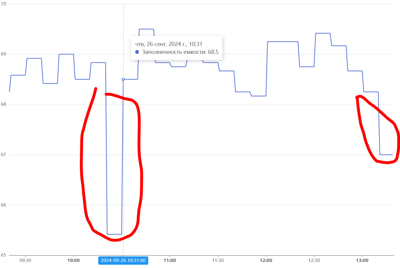

I’m getting data from the ToF sensor about the sewage tank fullness. Every 10 minutes Tasmota wakes up, sends data touch MQTT and falls asleep again. Sometimes the sensor sends erroneous data. I have marked them on the graph. The best way to filter out such data is a median filter. To do this I need to have a cache of the last N values

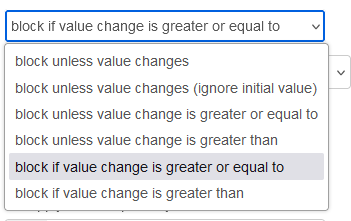

I use this to filter faulty values, but changed the filter criteria if the difference is too big.
sorry - bit OT for now, but stay with me.
If I understand this correctly, this one does filter out values, not within a certain pattern?
I would like to add to this if possible a variation in percentages instead of absolute values?

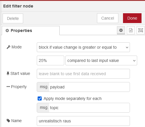

Reason I ask is, that I switched (since a long time) to using Node-Red for gathering information and ā€œpre-processingā€ those and then sending cleared ones to openHAB using the ā€œfilter nodeā€.
I also have some devices that are prone to send faulty values from time to time, which could potentially lead to really not expected behaviours of my rules.
So - that was my first thought reading this:
Use node-red as a pre-processor. Currently many MQTT-values get read from a node-red flow, get checked through a filter (like screenshot above) and are then sent in MQTT topics, which are read by openHAB. If the kind of filtering node-red offers in the filter-node can be done within openHAB, I’m very happy to use it!
