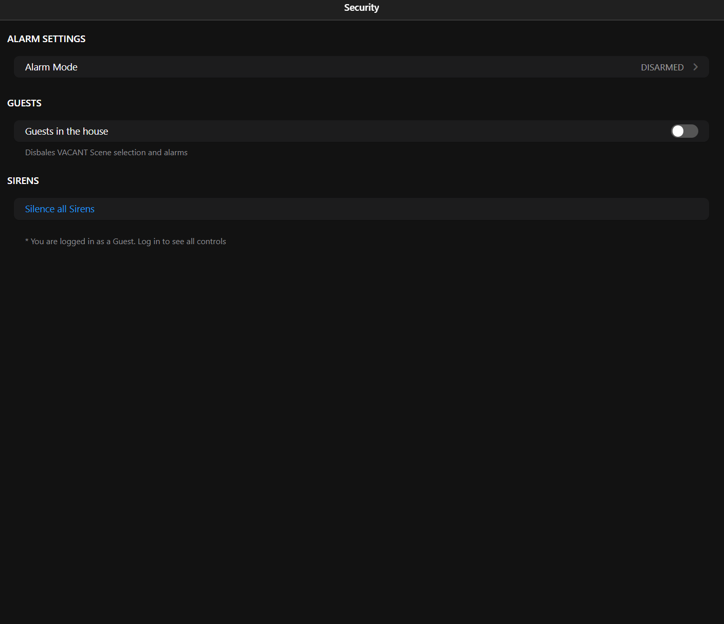

This is an example that uses this technique to show/hide a footer I add to every page
component: f7-card
  content: "* You are logged in as a Guest. Log in as an Administrator to see all controls"
  noBorder: true
  noShadow: true
  visible: "=(!user) ? true : false"
  style:
    background: hsla(0, 0%, 100%, 0)
    font-size: 12px
    margin-bottom: -10px
    margin-top: -20px
  textColor: gray
VIEW WHEN LOGGED IN
GUEST VIEW
You can remove individual buttons and switches, rows, columns, blocks, widgets etc
