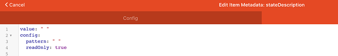

Yes. It’s all Item metadata. Look at the code tab when you define the Item metadata. At the top of screen you’ll see something like Edit Item Metadata: stateDescription. That last part is the namespace. Then you’ll see a value and config. Those are all represented in the items file as
namespace="value"[config1="config1", config2="config2"]
given
the metadata would be
stateDescription=""[pattern=" ",readOnly=true]
or something like that. I don’t use .items files any more and am stepping back from supporting them here on the forum. I’d rather spend my time elsewhere right now and helping out with syntax errors in text configs is a huge time sink.
