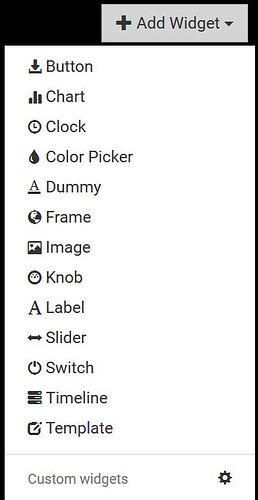

Go to your dashboard, enter edit mode, on the right hand side click on “Add widget”, go to the gear sign right next to “custom widgets”, click on it … voila, the “import” button appears.
Edit: disregard. You are not meaning any custom widgets, you are looking for the standard timeline widget?
Just go to “Add Widget” and select “Timeline”

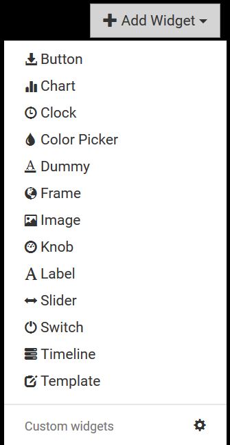

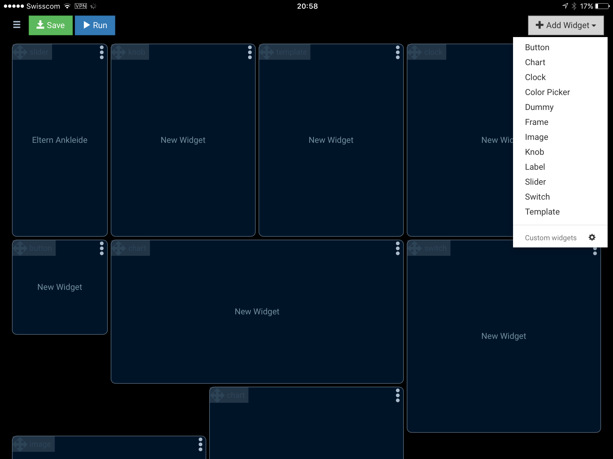

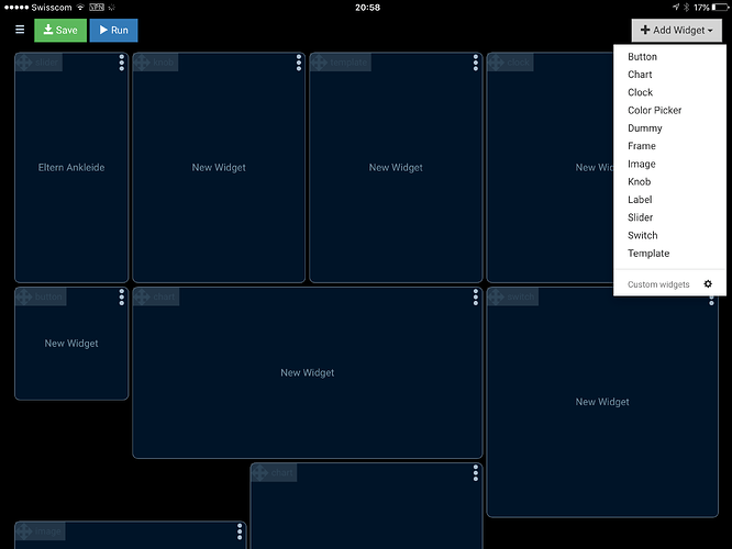

Dear Sihui
Thank you very much for your reply
Yes, I mean the standard timeline widget. It does not appear in the widget Dropdown. I tried to add it via github but did not succeed to download it.
What do I do wrongly?
Best Rolf
I think I got it: Timeline widget is only available in the snapshot release …
Exactly, the timeline has been added after the stable 2.0 release so you have to upgrade to get it.
