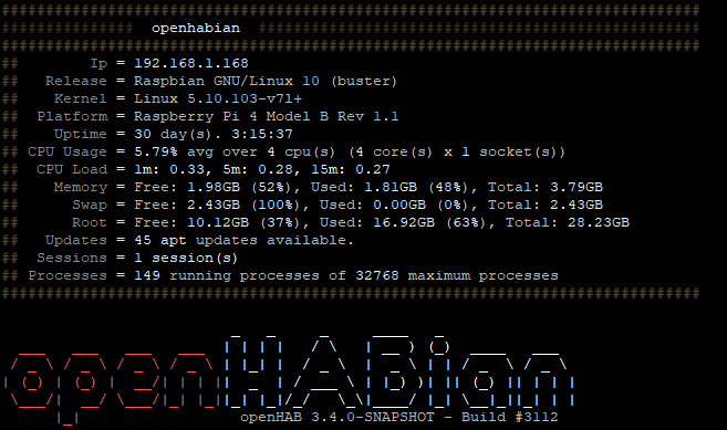

Transplanting my Z-Wave network (20+ devices) from Windows to openHABian was absolutely smooth.

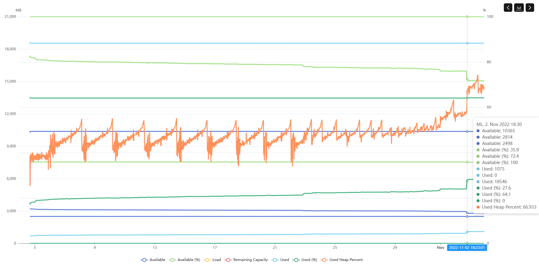

Impact on ‘Used Heap Percent’ is about 10 percentage points:
