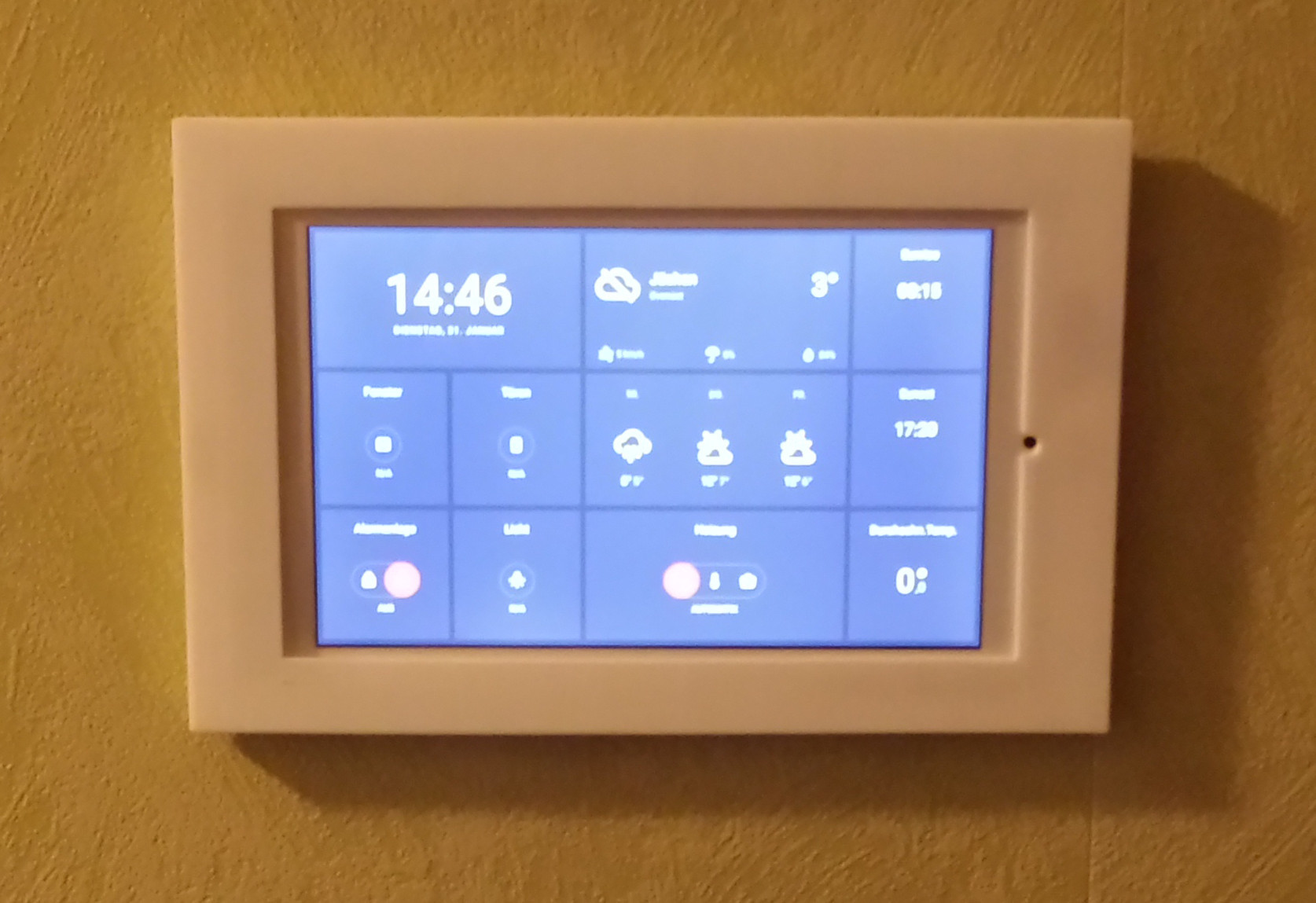

Why not design a perfect fitting frame and have it 3D printed, like I did …
Power supply is hidden in wall behind the tablet…
