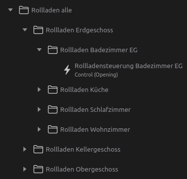

With the update to OH 4 I started from scratch and rewrote all my rules because I had the same problem: too many individual rules for basically the same functionality. I now went for the one rule fits all approach in most cases. It is very rewarding when you have a rule that just works also for other rooms when you add more equipment to your smart home.
So based on your requirements I can give you a rough idea how this might work:
  • Room A: Turn on light at sunset, close shutters
  • Room B: Same logic but different times/parameters
  • Room C: Same logic again but other parameters
  1. By applying consistent use of the semantic model in your setup it is relatively easy to find all lights/shutters/whatever in a location. So if you make sure that items are all tagged the same if they represent the same kind of control (e.g. a light switch) you don’t have to deal with concrete items/item names at all.
  2. item metadata: add custom metadata to your items for individualisation. For example I dim the lights during the night time but have set individual brightness levels for the lamps applied via metadata. You can also use metadata to exclude certain items from this logic (e.g. don’t dim the light on the terrace because if its on at night I am probably sitting there and want the light to be exactly like it is).
  3. Triggers: add all items that should trigger rules to groups and trigger the rule when anything in this group happens (updates/changes). Examine the trigger to find out which location is affected and proceed with finding relevant items and metadata as described in 1. and 2. Since you are talking about time based triggers you may also decouple this: you could add an item per location to determine whether it should be in day or night mode in this location and update this item when the corresponding time has come. Then use this item as part of a trigger group to proceed as described above.
You may or may not take this approach but I’m very happy to find all the logic in one place now and rules are still readable when it comes to length (use functions wherever possible to increase readability). All in all I think in a lot of cases this does not necessarily lead to overly complicated rules.

However, I don’t like the idea of putting all the items that can trigger a rule into one group
I have created non-semantic groups for all devices.
I wonder if this can be applied to them somehow.
Or is it better to do it all via the semantic model?
Can we perhaps move this conversation to the other thread, because this is actually off-topic here
Why?
You can have a separate functional hierarchy of Groups and Items from the semantic model. The semantic model is strictly a model of the physical layout of your home automation. No Item can be in more than one location at the same time.
Just thinking about it makes my inner Monk start crying :see_no_evil:
Is there an intended or preferred way or are both ways equally good?
But there is nothing wrong with it. You can use groups for various reasons, I also use groups just to make it easier to find similar items or to control how items are persisted.
They solve two different problems in two different ways. It would be unusual if you didn’t use both, particularly for controling the home automation like you descrbie. The semantic model helps you access and managed the stuff based on the room they are in. The functional model helps you access and manage the stuff based on what the Items do or represent, though the semantic model can help you with that too.
