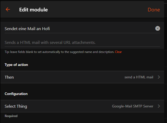

How to send mails in OH3?
I have tried:
configuration:
config: mail:smtp:6095998bde
type: mail.sendHtmlMail(“c.hof......er@gmail.com”, “Es klingelt an der Haustür”, “Jemand steht vor der Hausür”, “http://10.0.0.51/jpg/image.jpg”)
label: Sendet eine Mail an Hofi
But that ends in error.
In OH2.5 this had sent a screensot from a camera.

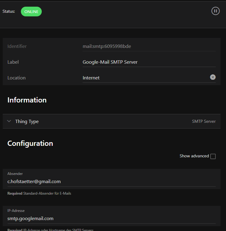

Yes, I installed the binding and set up the SMTP server as “Thing”, it is also online.

The rule then immediately shows an error message when I enter the last part (mail-#@address, subject, link).
INVALID_RULE
Validation of rule 0ca79312a0 has failed! Action Type "mail.sendHtmlMail(“c.ho......er@gmail.com”, “Es klingelt an der Haustür”, “Jemand steht vor der Hausür”, "http://10.0.0.51/jpg/image.jpg")" does not exist!
The link isn’t the reason, it doesn’t work like this either:
“mail.sendHtmlMail(“c.hof.....tter@gmail.com”, “Es klingelt an der Haustür”, “Jemand steht vor der Hausür”, “du nervst”)” does not exist!
OK, so you are using the mail action directly and not from a Script Action. The best I can offer at this point is to file an issue on the binding and see where that goes. I’ve not done that yet so I don’t have any experience to draw from.

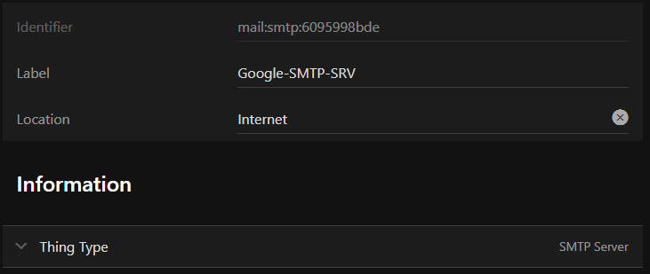

I’m too stupid, now I’ve tried it that way:
Script:
val mailActions = getActions(“mail”,“mail:smtp:Google-SMTP-SRV”)
mailActions.sendMail(“c.hofstaetter@gmail.com”, “Es klingelt an der Haustür”, “Jemand steht vor der Hausür”, “http://10.0.0.51/jpg/image.jpg”)
but I get an error message again:
2020-11-13 18:11:12.553 [ERROR] [internal.handler.ScriptActionHandler] - Script execution of rule with UID ‘0ca79312a0’ failed: :1:4 Expected ; but found mailActions
^ in at line number 1 at column number 4
This is my SMTP-Server thing:

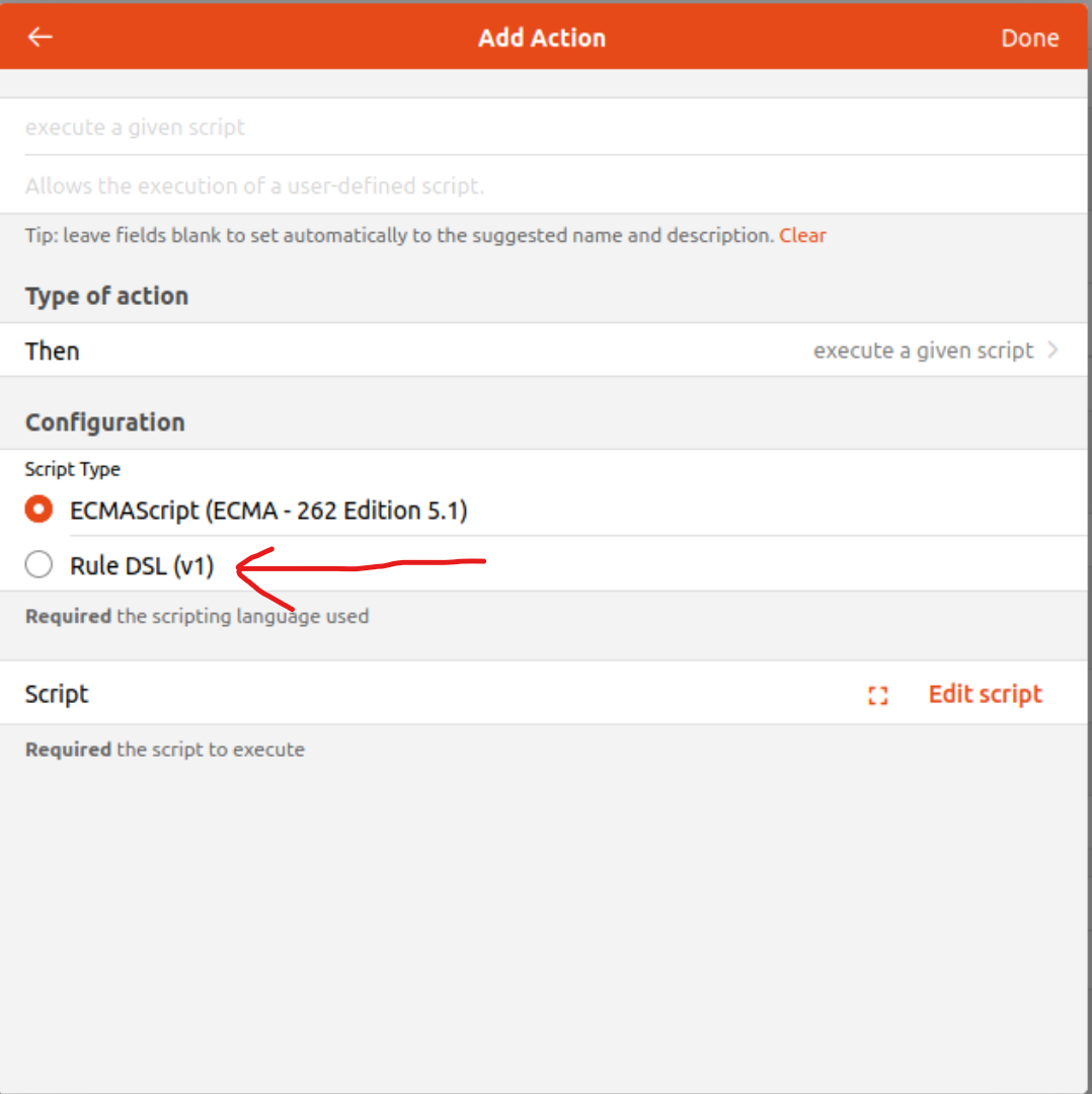

OK, I think the problem here is you chose ECMAScript (aka JavaScript) as the language for the Script Action but the code is Rules DSL. I don’t know if you can change the language after the fact or not. You might need to delete it and recreate it. this time select “Rules DSL (v1)” as the “script type”.
Then you can paste int the same code and it will at least be the right syntax.

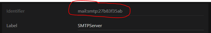

I would always have entered the label of the mail server:
val mailActions = getActions(“mail”,“mail:smtp:SMTPServer”)
But if I enter the identifier it works:
val mailActions = getActions(“mail”,“mail:smtp:27b83f35ab”)
I tried that yesterday, but the wrong script language was selected. Now that the script language fits, thanks to your help, it worked immediately after switching to the identifier.

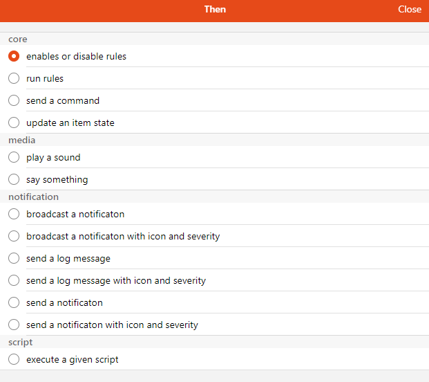

Hello all, I’m really interesting with realizing simple rule only with UI (and thus without my buggy scripts) but I really don’t find how to send mail from the action part of the rule editor.
At the top of this topic (Nov 13, 2020), there is a print screen that show the user can select to send mail in the actions through a thing. I’ve tryed many thing but it’s impossible for me to choose sendMail… I just have following list :
By the way, I fully succeed to send mail with scripts which indicate that the mail binding is correctly configured.
That never worked. Actions that can’t work are no longer listed. It’s never been possible to send an email without using a Script Action and doing it in code.
