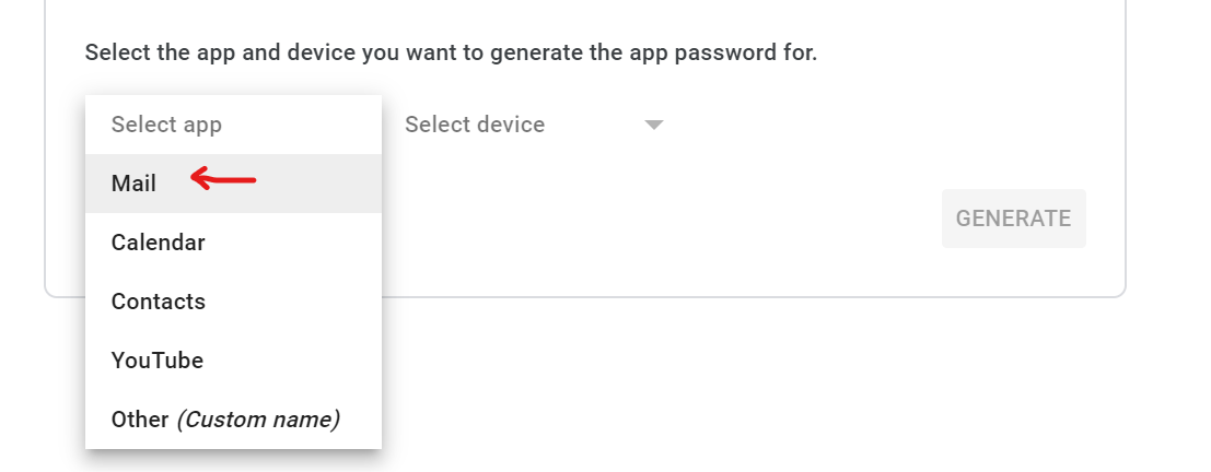

Select “Mail” for the app:

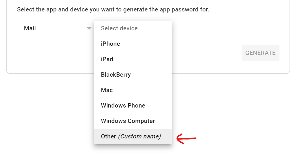

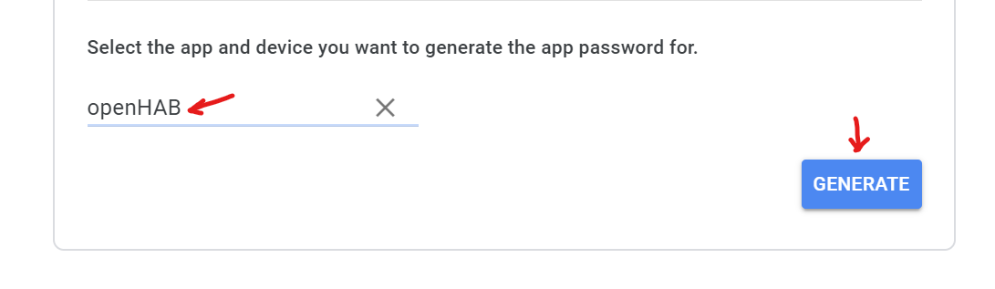

Enter “openHAB” for the device and hit generate:

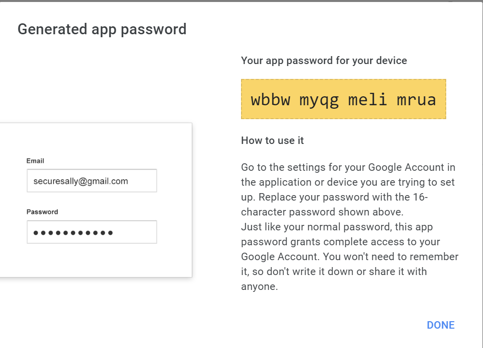

You will get your app password in the yellow box:
NOTE: I deleted this app password before posting this tutorial so it’s useless.
This will be the only time you see the actual password. If you don’t copy the password now and enter into OH you will have to delete this one and generate a new one. So leave this page open until you are ready to enter the password into openHAB.

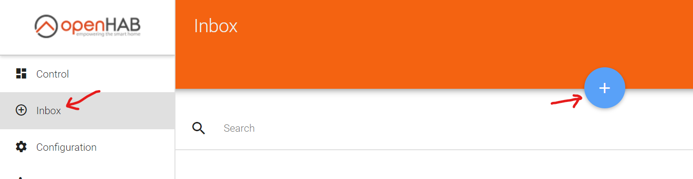

Click on Inbox and the blue + icon.
Select “Mail Binding” from the list and then select “SMTP Server” from the next list.
