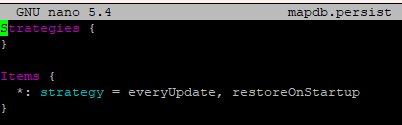

Currently i have installed the mapdb binding and created a mapdb.persist file under: /etc/openhab/persistence/ where i entered as sudo user the following code:

Your persistence settings are defined to store the state on every update, but restore state from persistence is only done when openHAB is started. It does not mean to restore when a device is readded/reinserted.

With restoreOnStartup, the Item states are updated.
