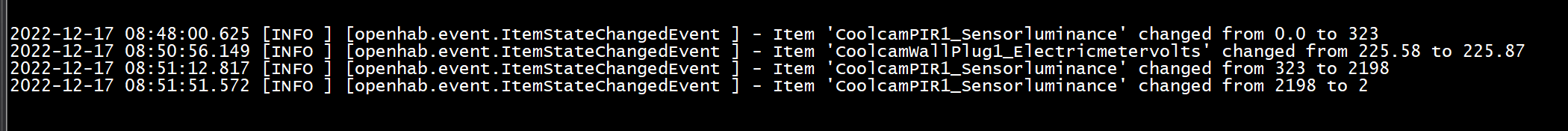

  • This happens in the event.log when the luminance value changes:
I got the “command” from the logs, added to my original post but it seems not to work like that…
As you can see in the snippit from my event.log i think the value is just nummeric/point no lx or something. I’m not sure if operators like < or <= are supported. Based on the event.log i would say something like this must work:

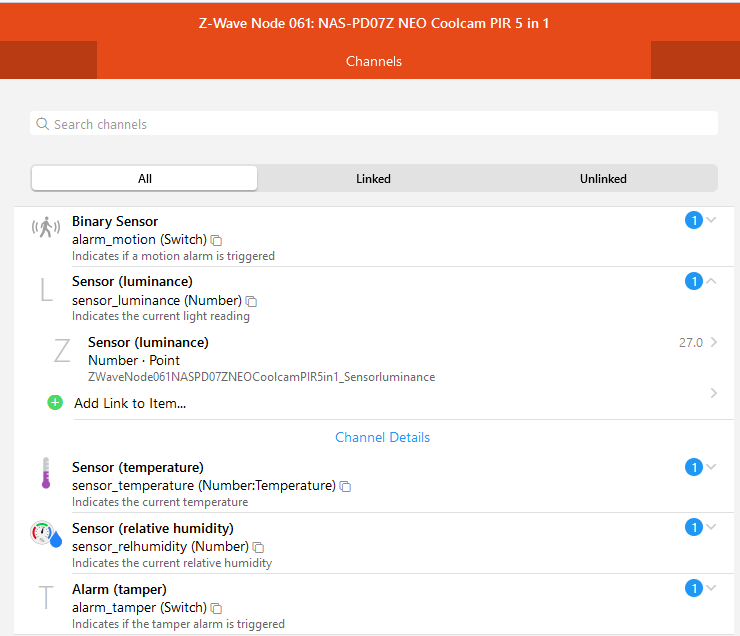

I tend to agree that your luminance is dimensionless. Please check the luminance channel of your device:

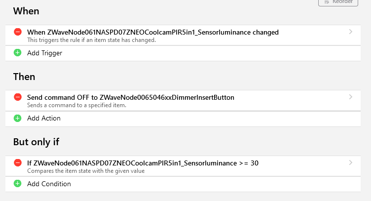

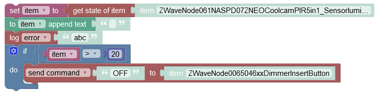

I think you would have to use a ‘When … changed’ luminance trigger and either
check within a script whether the luminance is above/below your threshold
or to use a “But only if” condition:
configuration: {}
triggers:
  - id: "1"
    configuration:
      itemName: ZWaveNode061NASPD07ZNEOCoolcamPIR5in1_Sensorluminance
conditions:
  - inputs: {}
    configuration:
      state: "30"
      operator: ">="
    type: core.ItemStateCondition
actions:
  - inputs: {}
    configuration:
      itemName: ZWaveNode0065046xxDimmerInsertButton
      command: OFF
    type: core.ItemCommandAction
Both approaches work for me.

That’s okay, as @anon71759204 suggests, you can trigger on any change (or update) and then do a “greater/less than” comparison in a condition section.
So from your first post. this looks right
trigger - condition - action
