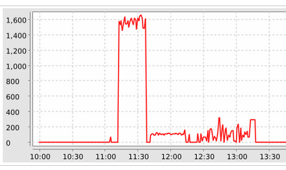

Great washing machine by the way. Most modern ones I come across still have a small standby power consumption :frowning: or was your machine switched off already when you got the 0.0 reading and therefor the initial rule was never triggered as the power might be slightly above 0 and needs adjusting?

lower than 1 or some other appropriate low value, which should be double checked with his machine. But as I stated in the other thread, a timer is probably needed as well, to catch low power readings during the cycles.

Example of the troubles that can arise, for later readers -
