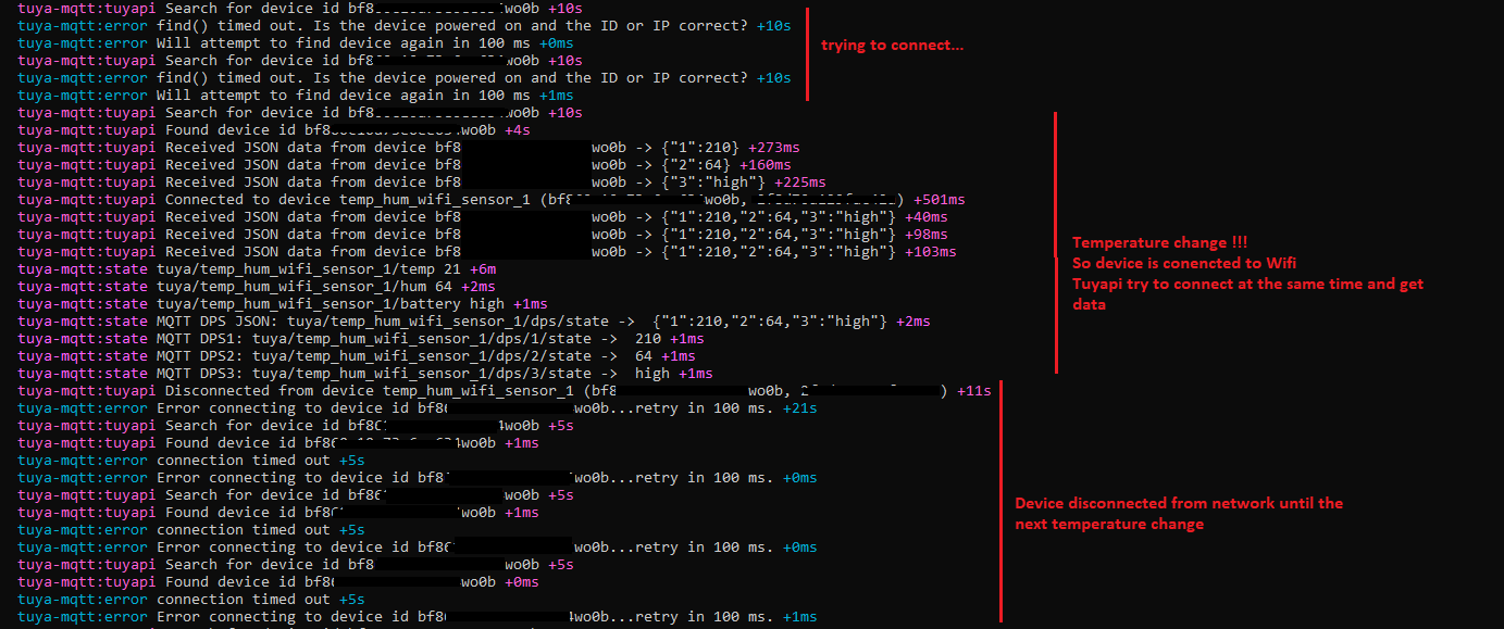

Here is a screenshot with more explanation with tuyamqtt in debug mode. No problem with devices that are always connected to Wifi (like my switches).
But the problem is when a device is only connected for only 2secondes to send its data to the cloud.
You can see I have decrease the reconnection time to 100ms. But by befault it is 10sec.
See with this bad solution, the api manages to connect when the device connects, sends its data and then disconnects.
But how do you do this without trying to connect to it all the time?

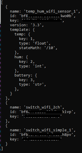

Here is my devices.conf:
