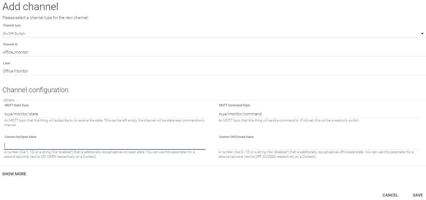

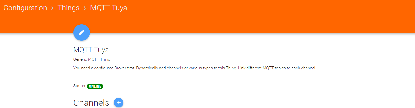

  2. Next you have to define your MQTT-channels - I simply did that via PaperUI. Use a “Generic MQTT Thing” (for example “MQTT Tuya”) and add your channels here according to your devices.conf:
