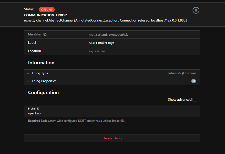

I went to the Openhab MQTT bindings and tried to scan and install them. One came up and is online (but has no channels) the other says error in communication.

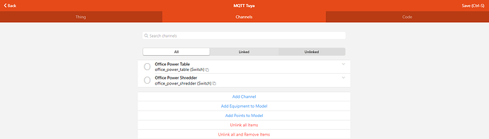

You can‘t scan for the MQTT-Channels, you have to define them manually - for example:
PS: On your screenshot it seems that you didn‘t specify the right MQTT-Server data: Please check your IP and Port-Settings
How do I set the MQQT server data?
how do I get to this page?
Hang on, you don’t need the system broker - you can delete it… On the other mqtt-thing on top you have the tab “Channels” - here you can define your MQTT topics:

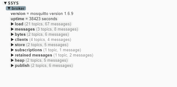

I’ll download and try the MQTT explorer and see what details that gives.
Downloaded and tried this is what I found… i’m not sure if I’ve even set the MQTT server up properly…
So tuya-mqtt isn‘t sending any data to the broker. Try to remove the colon at the end of your devices.conf and make sure node tuya-mqtt.js is running - then you should see it in MQTT explorer
