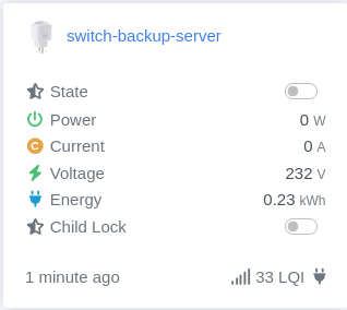

For me NOUS A1Z zigbee-plugs work really fine. I run them connected via zigbee2mqtt. They are detected correctly right from the start, no flashing needed. I use zzh zigbee-stick.
I cannot tell you how accurate the power metering is.
On the following screenshot you can check which information you get from the plug.

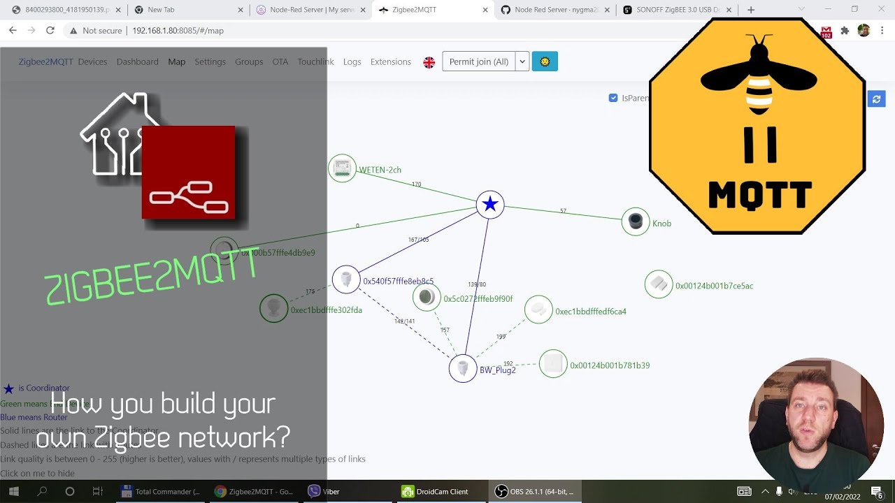

It does a good Zigbee network map:
