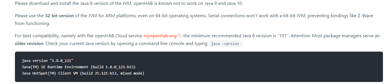

so in theory, we are ok with regards to the min requirements (1.8 Build 101?). What do you think @Benjy ?
Anyway… the PR is in the right direction since Azul does not update it’s repos anymore (I just saw it)
Not anymore :wink:
Strange… although it was merged 5 days ago, I still see 101:
on Installation Overview | openHAB
btw, I opened up a small issue also: [#809]
I will make the PR now also (when I edit the openhab-docs/installation/index.md I see 161)
PR done: [#810]

On that note, and that Zulu is the preferred OHv2 set-up, is there somebody who has successfully installed Zulu on a new Stretch Lite on a rPi3 and can list the steps taken to get there.
I get the principle of it; e.g. if there is no apt-get install, a key needs to be added, then a repo added, then apt-get update to download the files; then install the package with apt-get install. However non of the docu I have tried gets me there: neither java nor zulu.
Any help appreciated.
If you go the Zulu way, you can follow Ben’s instructions here: HowTo: Install Zulu Embedded Java on Raspberry Pi 3 - #37 by Benjy
This is the manual (not apt) based method to install since Zulu packages are not up to date.
If you go the Oracle way using apt, try:
sudo su
rm /etc/apt/sources.list.d/zulu.list /etc/apt/sources.list.d/webupd8team-java.list
rm -rf /var/cache/oracle-jdk8-installer/
echo "deb http://ppa.launchpad.net/webupd8team/java/ubuntu xenial main" | tee /etc/apt/sources.list.d/webupd8team-java.list
echo "deb-src http://ppa.launchpad.net/webupd8team/java/ubuntu xenial main" | tee -a /etc/apt/sources.list.d/webupd8team-java.list
apt-get autoclean
apt-key adv --keyserver keyserver.ubuntu.com --recv-keys C2518248EEA14886
apt-get update
apt-get install oracle-java8-installer oracle-java8-set-default
apt-get purge zulu-embedded-8
both ways are fine for OH2
Thanks for hanging in there!
Started again, and instead of doing my basic (standard) config, I went straight to the Java install.
After neither one completed, and showed segmentation errors, I got suspicious about the 16GB SanDisk SD card; am currently testing it, and it has thrown umpteen sector errors. This is good enough to get some new cards in the local shop and start over.
Interestingly enough this 16GB card has been running for 420 days, before I used it yesterday to build a OHv2 rPi3.
Is it safe to say that Zulu is where OH is going?
The tar ball I downloaded had eval in its name; and I see pricing information for their product on their site. Can we be sure this package remains ‘free’ to use? If I understand this JAva business somewhat, it seems Oracle wants some money if used in production, and whoever can afford it will leave this brand behind, why it is no longer included in distros?!
If all this has some merit, and Zulu is the next best thing, then this is the way forward, and the way that should be promoted.
Will update in the coming days how the new card went.
