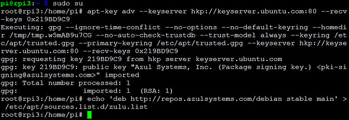

A. Login into your rPi3, switch to root, import Azul’s public key and attach the Azul APT repository.
Commands:
sudo su
apt-key adv --keyserver hkp://keyserver.ubuntu.com:80 --recv-keys 0x219BD9C9
echo 'deb http://repos.azulsystems.com/debian stable main' > /etc/apt/sources.list.d/zulu.list

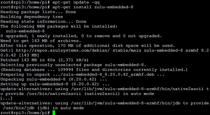

B. Update the information about available packages and install the Zulu Embedded (ARM32bit JDK Hard Float) package.
Commands:
apt-get update -qq
apt-get install zulu-embedded-8

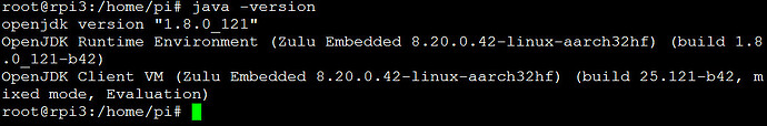

C. Verify the installation:
Commands:
java -version
(optional step): Use the following command to make sure that the new Zulu JDK is being used as default:
update-alternatives --config java
