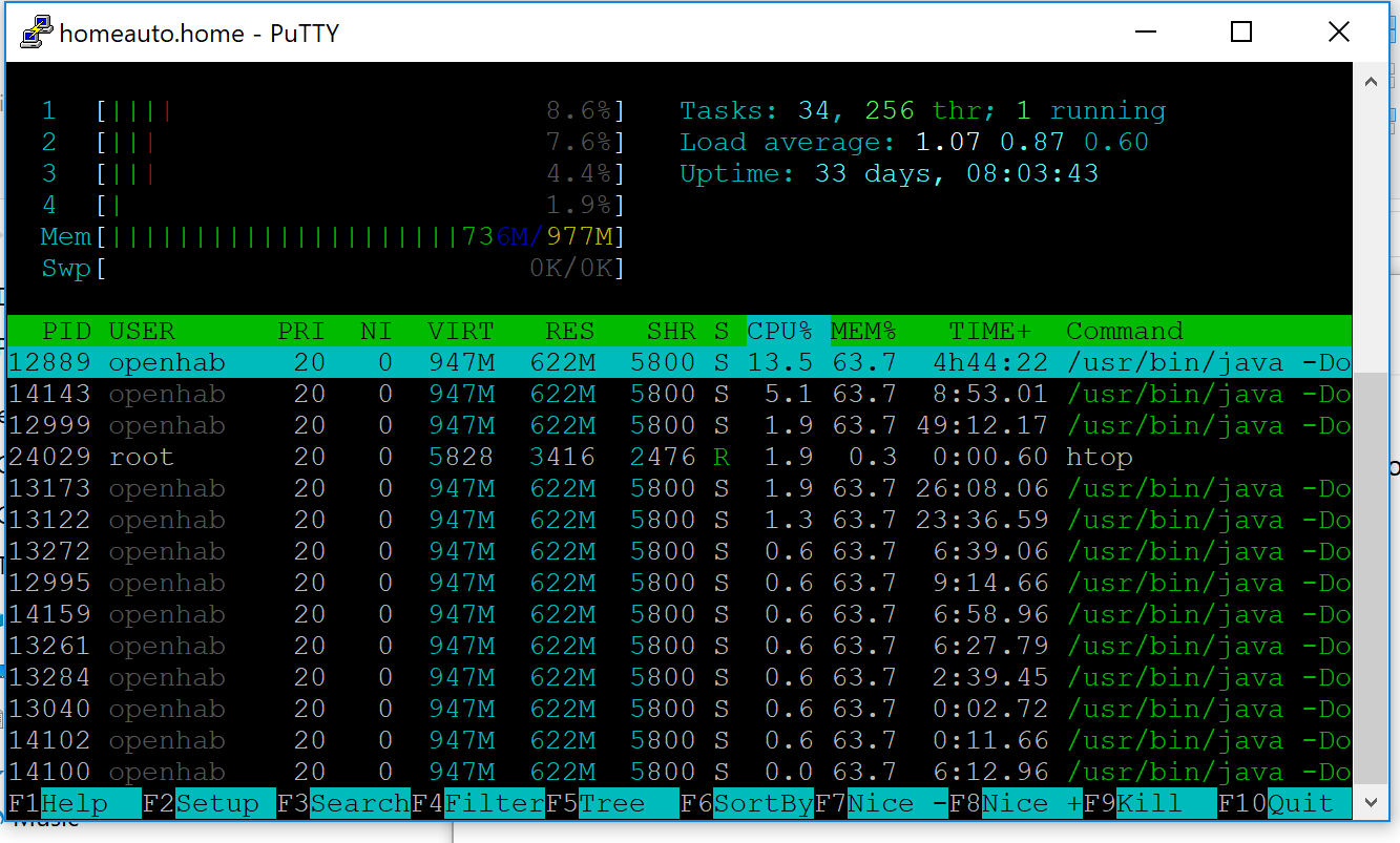

For the record, this is my current RPi3
You can see, memory was a problem…
