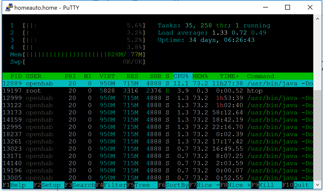

For the record, this is my current RPi3
You can see, memory was a problem…
Thank you very much for this great information. Yes memory was becoming a problem. I suppose that is solved now.

Never seen any ARM based OH to use way more than 700MB.
BTW only the resident part is relevant so you don’t/didn’t have problem
(ok, the difference is being paged out so it affects SD card wearout but that happens only more or less once per OH run).
What -Xms (and -Xmx) options do you use ?
I did push it up to, IIRC, 512. I did it a while ago when there was a lot of chatter about the rules and them being cached. I have a lot of quick-run rules and thought it would help.

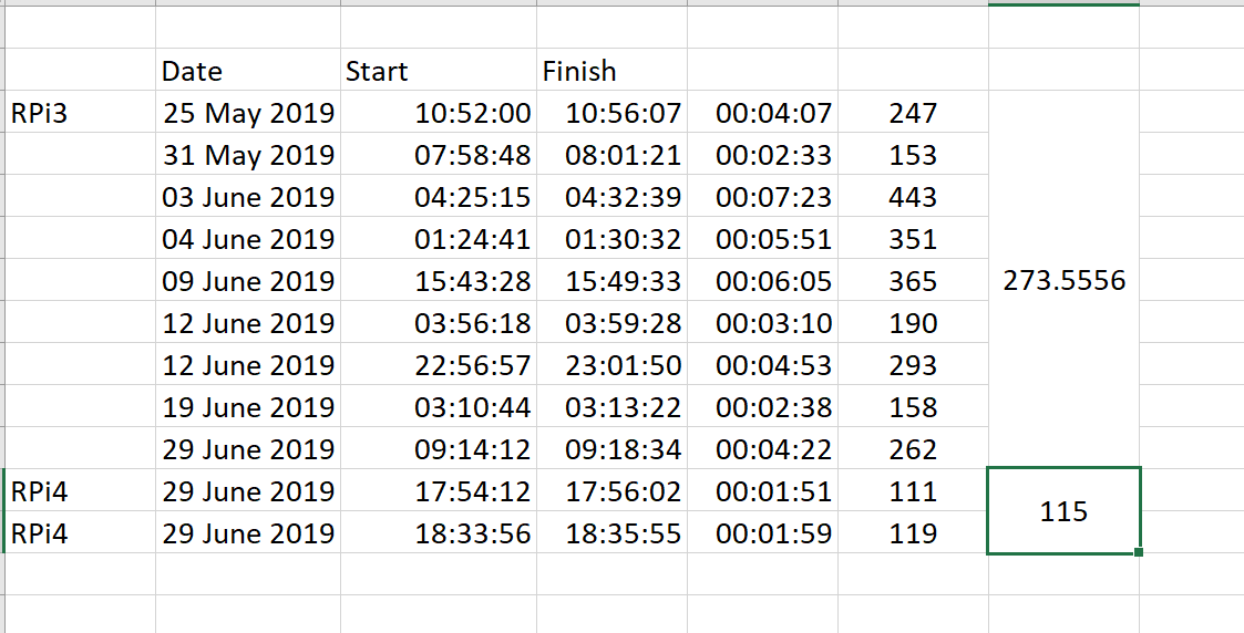

Another update -
This is the rpi3B+ after (service) running for a day, during the day.
Some interesting start times, and while it’s not conclusive, it’s interesting
Above is the time diff between the following lines in the log
[.core.internal.i18n.I18nProviderImpl] - Locale set to 'en_GB'.
and
[ternal.dhcp.DHCPPacketListenerServer] - DHCP request packet listener online
Between those two lines in the log file all items, things and rules are loaded. I figure it’s a good enough set of markers. If there is a better option then I’ll remeasure it.

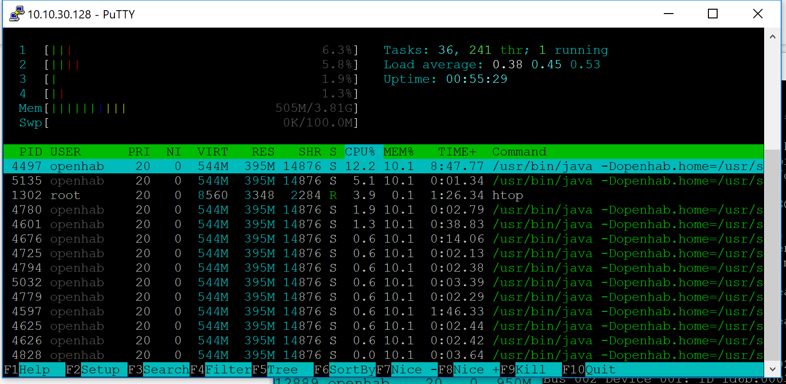

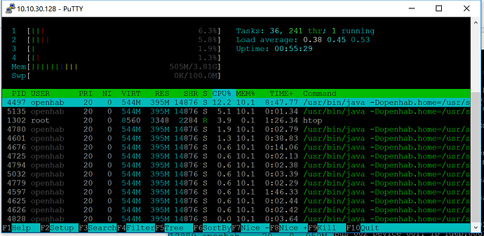

Below is the htop of the RPi4 after 20ish minutes of running my “production” OH2 setup.

Correction - I have the following:
xmx650 / xms400
Question - On the 4GB model, any benefit in making that higher now? Or leave it default?
