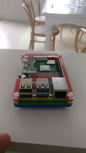

@Seaside .. did you break the red layer in that case whilst assembling it.. like I did ?
No, but the transperent layer got broken. Fixed it with superglue. If you have access to a 3d printer there are a lot of free options for various cases Search Thingiverse - Thingiverse
