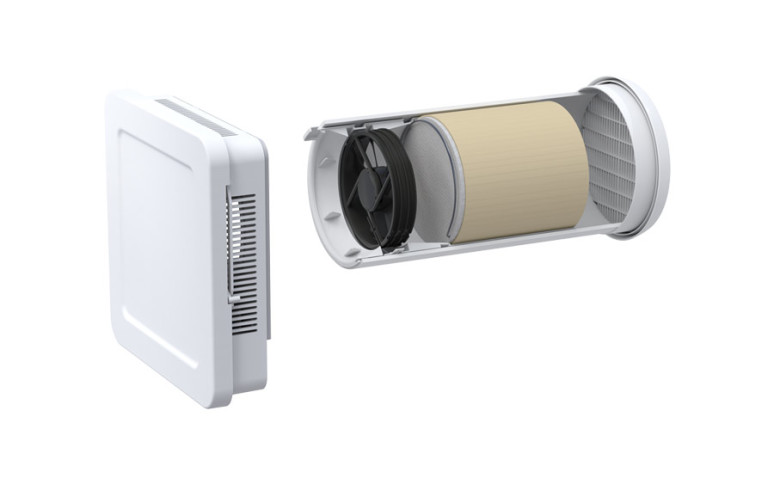

For my new home I plan to implement some decentral controlled domestic ventilation (in german kontrollierte, dezentrale Wohnraumlüftung). My favorite device for this is the Siegenia Aeromat VT WRG 1100.
It could be controlled via Siegenia Sensoair (which is a zWave enabled device, but not really stylish) or via wires.

Aeromat need to have a a full power off switch.
S1 = Fanspeed 1 (low)
S2 = Fanspeed 2 (high)
S1 + S2 = Automatic
Overall: I need 3 Switches, each controllable via zWave and OH
Power off
Speed 1
Speed 2
How could I realize it?
