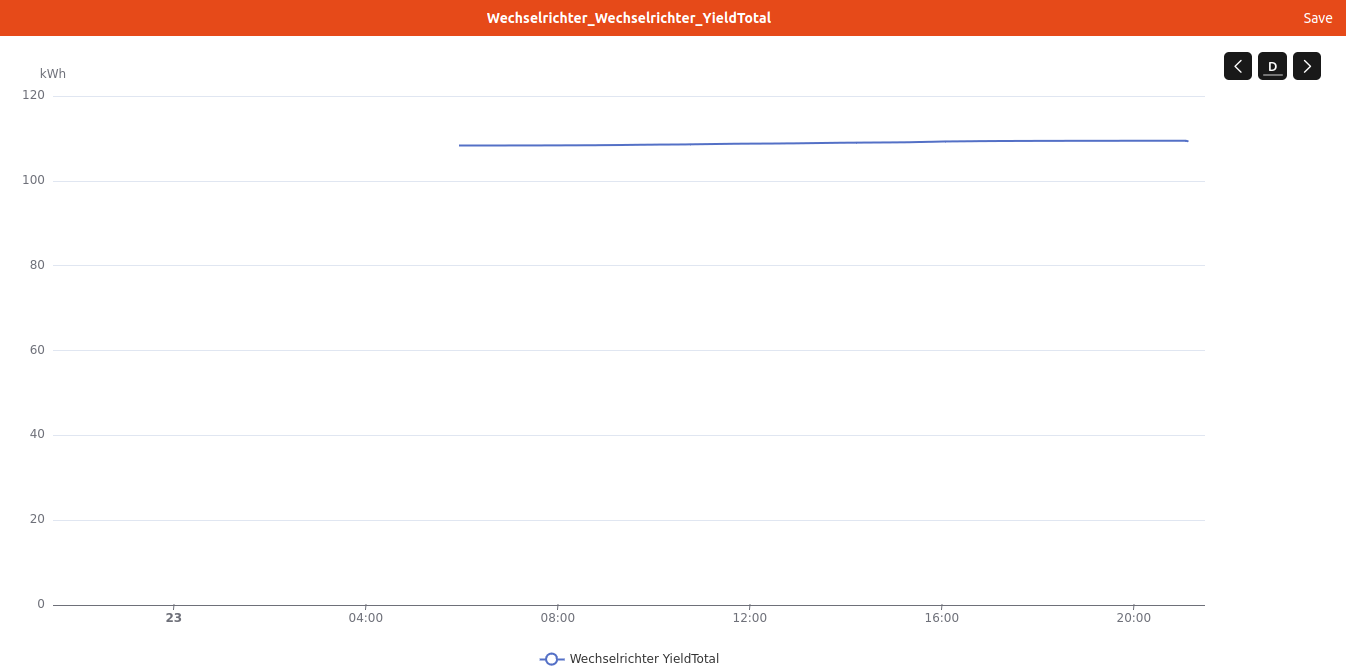

In my case, outside of the times when the inverter is powered on (see example below)…
… the state of the items goes to UNDEF, which does not look nice in dashboards (more a cosmetic problem)…

Update: Maybe I’m looking at an MQTT problem / integration problem into openHAB. When running mosquitto_sub -h 192.168.0.150 -u username -P password -v -t solar/# the output shows the desired values even if the inverter is down (at night), so I have to check the MQTT channel tomorrow.

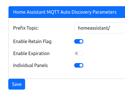

Solution: The flag “enable expiration” has to be disabled for the items to contain data without gaps when the inverter is switched off. I found the solution here on openDTUs Github page.
