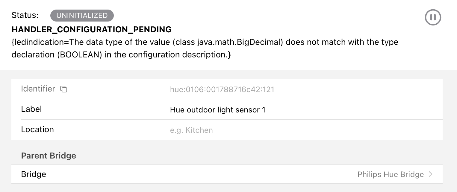

After upgrading to OH 3.3.0 the Hue light sensor stops working, it used to work fine with 3.2.0. I see the following error message in UI:
Any suggestion on what to do? Many thanks in advance!

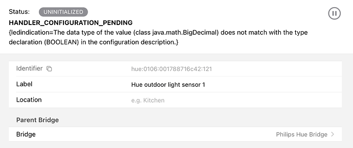

Check out 3.3 release discussion about 30 posts from the top. Ledindication needs to be true or false not 0.
Thanks! But I don’t follow this, the lumin sensor always returns a number, how could it return boolean value? I tried to remove and re-add the thing and now it seems to work fine…
