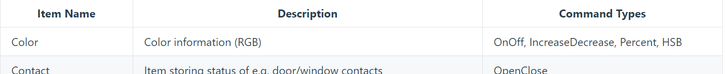

And even tho the Color item is a On/Off Type I can’t turn them on/off through alexa:

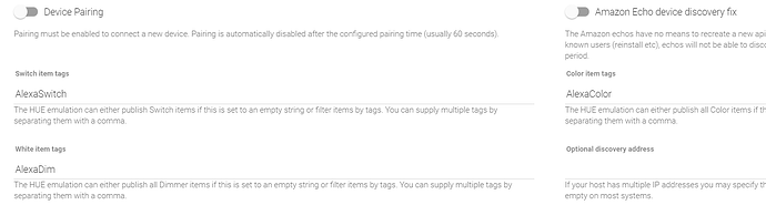

Have you read the documentation for the Hue Emulation binding? According to the doc you can tag a color bulb with “ColorLighting”, which Alexa should then be able to control as a color bulb.

I am running up-to-date openHABian on an RPi 3B, openHAB release 2.5.0-S1493-1. I do not see that information when I open the Hue Emulation Binding dialog box:
Let me know which one!
I’m running the latest OH version on a RPi 3b+
to rename the tags? just rename it, it’s a textbox.
But it didn’t worked at first too, when the Tag was called “ColorLighting” but I’m gonna try it just to be sure!
As I said, it gets detected but its not controllable like a colorlight ..
Thanks for helping.
Edit:
renamed it to “ColorLighting”:
and it gets detected too:
But still the same Problem
