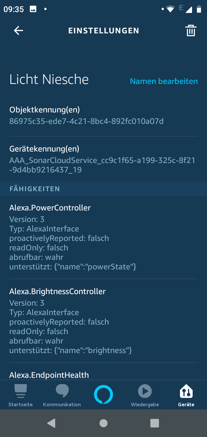

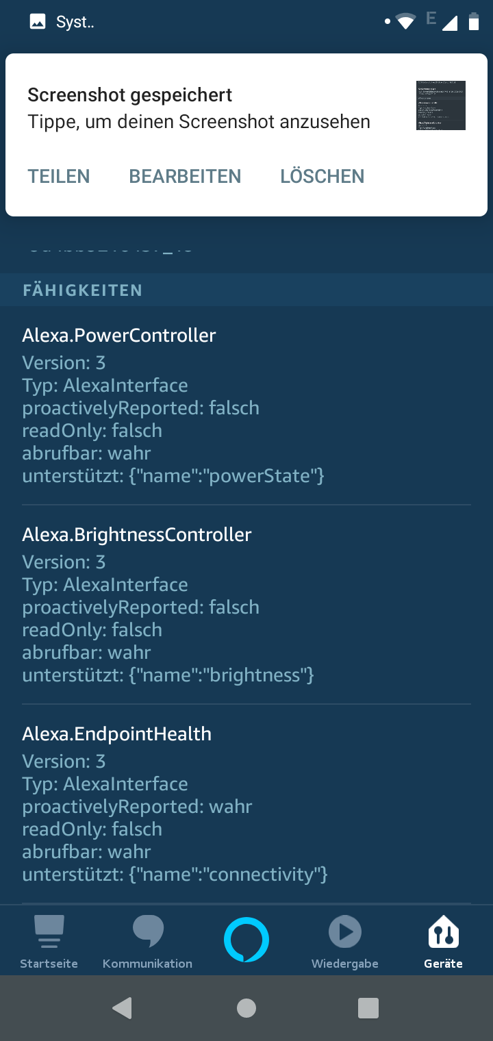

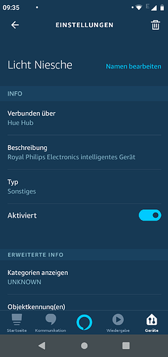

I again deleted and re-detect all devices but still not working with alexa to switch on/off.Screenshot_20190915-093515 Screenshot_20190915-093535 Screenshot_20190915-093539 .
