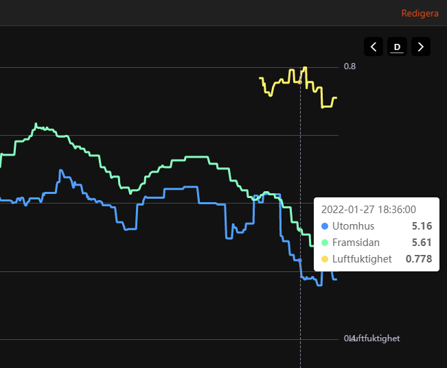

I created a chart with the outside temperature and humidity. Unfortunately the humidity displays a value between 0 and 1, instead of diplaying the humidity in percentage ( “Luftfuktighet” in pic1).

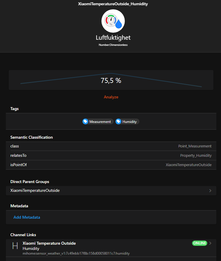

The item that I’m using diplays correctly when I look at the item (pic2) or when I use the item in a location.

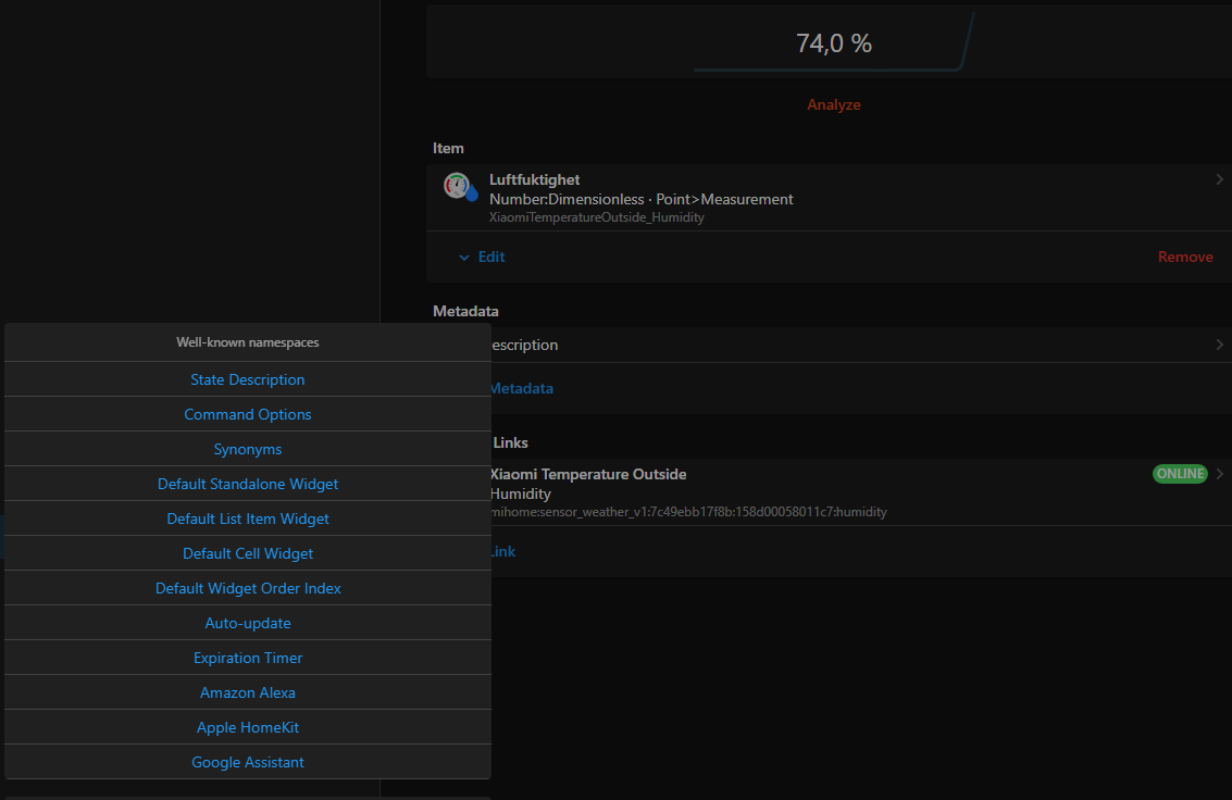

Edit your Item metadata ‘pattern’ to give it a default % unit.
Thanks for your reply but I don’t know how to do that. Can you point me in the right direction? The item is added through the OH3-UI.
Might help
You’re after State Description - pattern
and will want to put something like %.1f %%
Thank you @rossko57! That worked!
When you choose “Add metadata” in the OH3-UI for an item, you can choose “State description” and then add %.1f %% in the field “Pattern”.
