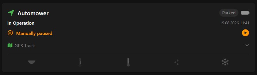

Husqvarna Automower Status Card
A status card for the Husqvarna Automower binding.
Husqvarna Automower only. Uses Husqvarna-specific activity strings (MOWING, LEAVING), error codes (0–12, 110), and Thing actions (parkUntilFurtherNotice() / resumeSchedule()).
Shows live activity (green/grey/red badge), error codes decoded to plain text, battery level (tap → Analyzer), and last-update timestamp.
Optional extras — all hidden when not configured:
  • Manual pause toggle — pause/resume the mower directly from the card; integrates with schedule automation via a NAND group

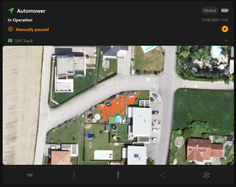

  • GPS satellite track map — collapsible accordion with today’s GPS track on Esri World Imagery (requires a companion HTML file copied to /etc/openhab/html/)
  • Weather guard strip — sunset / hot / cold / rain / frost icons; active guards are lit, inactive ones dimmed
Two setup tiers are documented: Tier 1 (five items, done) and Tier 2 (full automation with a NAND group, JS Scripting schedule rule, and Threshold Alert rules for weather conditions).
Screenshots
Changelog
Version 1.3.1
  • Removed the duplicate status sentence below the activity badge — it repeated the same MOWING/CHARGING/error info already shown in the badge next to the battery icon, using a hardcoded error-code table that duplicated the binding’s own status#error-message channel (already surfaced via the optional Summary Detail rule)
  • That row now shows only the Last Update timestamp
Version 1.3.0
  • Added Control Actions prop group with Home/Start/Pause button row (all optional — card stays status-only when these props are not wired)
    • Home button opens a park popover: 30 min, 3 hr, 24 hr, until next schedule, until further notice
    • Pause button (orange) appears when mowing/leaving; sends pause command to automowerManualPause item
    • Start button (green) appears when idle; sends resume command to automowerResume item
  • Added optional Work Area Name prop — shows the active work area below the status text
  • Improved inline status decoding: all activity/state values now show friendly labels (GOING_HOME → “Going Home”, CHARGING → “Charging”, NOT_APPLICABLE + IN_OPERATION → “Planning”, etc.) without requiring an external rule
  • Badge colour expanded: Charging → yellow, Going Home → teal (previously only Mowing/Leaving were coloured)
  • Bundled rules/automower_state_summary.js — community-contributed rule for richer status detail including work area progress percentage (advanced, optional)
Version 1.2.0
  • Added status overlay — semi-transparent chip in the top-right corner showing current lat/lon and last-updated time; appears once the first position is received
  • Fixed persistence fetch to use boundary=false, preventing OpenHAB from injecting artificial boundary points into the GPS track
  • Added Advanced: self-hosting section to README documenting how to serve Leaflet and satellite tiles locally for offline/resilient operation
Version 1.1.0
  • Added Persistence Service prop — dropdown selector (InfluxDB, RRD4J, MapDB, JDBC, or OpenHAB default) for the GPS track history service; passed to automower-map.html as ?serviceId= URL parameter
  • Reorganized widget props into three groups: Binding Channels, GPS Track Map, and Schedule & Weather Guards
  • Improved prop labels and descriptions throughout
  • GPS map setup docs updated to explain that RRD4J does not support Location items
Version 1.0.0
  • initial release

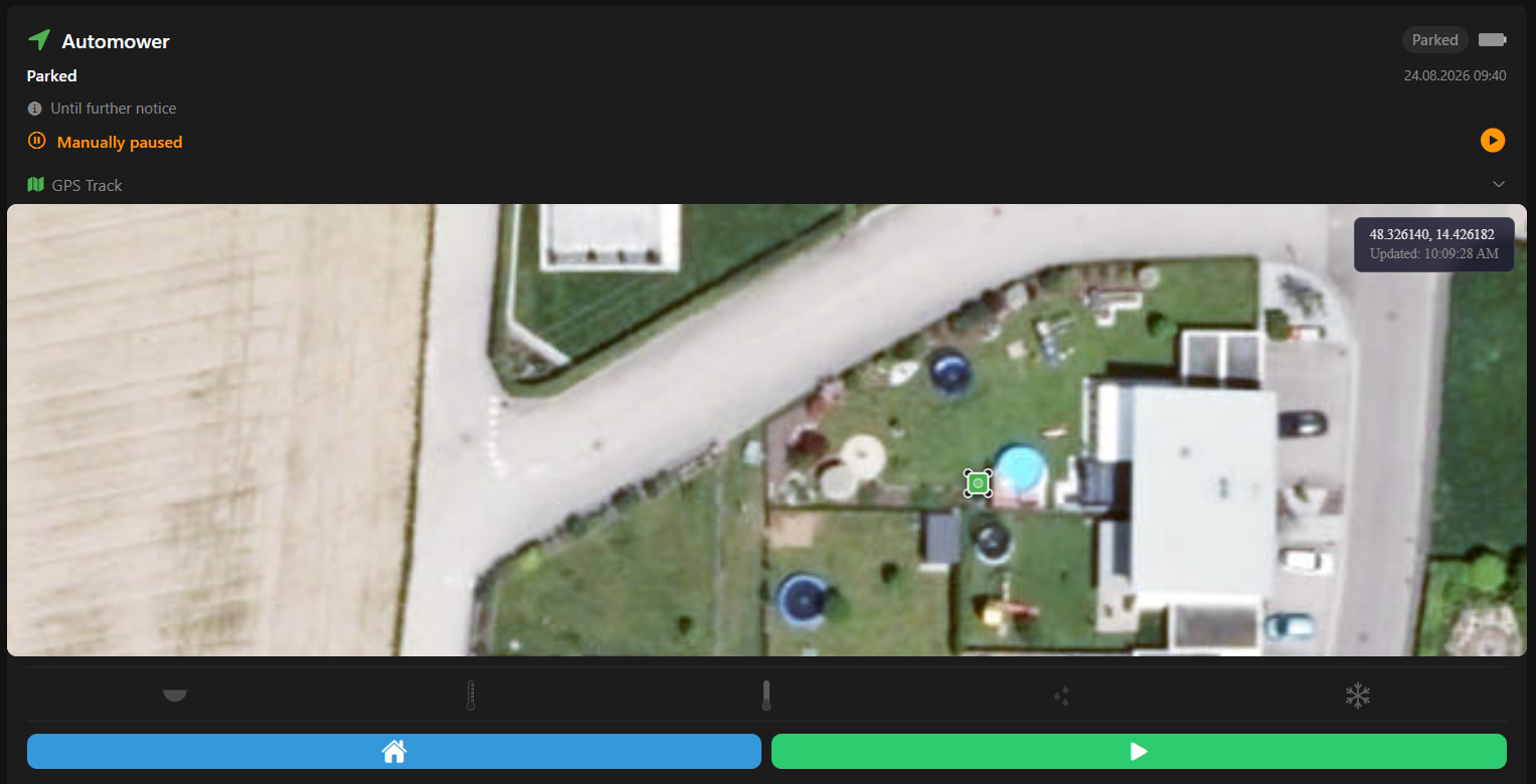

Hi @Ltty - Nice work - I had an initial look at this, and considering leveraging aspects for my local installation.
If you are interested, here are some suggestions:
  • Download and serve up the unpkg components from your local OpenHAB server
  • Ditto for downloading the Tiles, and serving them up from your OpenHAB server
I am definitely a fan of minimising dependencies on external systems/sites, so doing the above should help take these out of the mix, e.g. :
# Create directory tree
sudo -u openhab mkdir -p /etc/openhab/html/mower/leaflet/images
sudo -u openhab mkdir -p /etc/openhab/html/mower/tiles
# Download Leaflet JS and CSS (pinned to v1.9.4)
sudo -u openhab curl -sSL https://unpkg.com/leaflet@1.9.4/dist/leaflet.js -o /etc/openhab/html/mower/leaflet/leaflet.js
sudo -u openhab curl -sSL https://unpkg.com/leaflet@1.9.4/dist/leaflet.css -o /etc/openhab/html/mower/leaflet/leaflet.css
# Download standard Leaflet marker assets (referenced by leaflet.css)
sudo -u openhab curl -sSL https://unpkg.com/leaflet@1.9.4/dist/images/marker-icon.png -o /etc/openhab/html/mower/leaflet/images/marker-icon.png
sudo -u openhab curl -sSL https://unpkg.com/leaflet@1.9.4/dist/images/marker-icon-2x.png -o /etc/openhab/html/mower/leaflet/images/marker-icon-2x.png
sudo -u openhab curl -sSL https://unpkg.com/leaflet@1.9.4/dist/images/marker-shadow.png -o /etc/openhab/html/mower/leaflet/images/marker-shadow.png
Gemini threw together a file for downloading the tiles as follows:
import os
import math
import time
import urllib.request
# Bounding box derived from your KML polygon coordinates with a buffer
NORTH_LAT = -xx.yyyy
SOUTH_LAT = -xx.yyyy
WEST_LON  = xxx.yyyy
EAST_LON  = xxx.yyyy
# Zoom levels 17 (neighborhood), 18 (property), 19 & 20 (high-res yard level)
ZOOM_LEVELS = range(17, 21)
OUTPUT_DIR = "/etc/openhab/html/mower/tiles"
TILE_URL_TEMPLATE = "https://server.arcgisonline.com/ArcGIS/rest/services/World_Imagery/MapServer/tile/{z}/{y}/{x}"
def deg2num(lat_deg, lon_deg, zoom):
    lat_rad = math.radians(lat_deg)
    n = 2.0 ** zoom
    xtile = int((lon_deg + 180.0) / 360.0 * n)
    ytile = int((1.0 - math.asinh(math.tan(lat_rad)) / math.pi) / 2.0 * n)
    return (xtile, ytile)
count = 0
for z in ZOOM_LEVELS:
    x_min, y_min = deg2num(NORTH_LAT, WEST_LON, z)
    x_max, y_max = deg2num(SOUTH_LAT, EAST_LON, z)
    # In Web Mercator Y increases going south
    for x in range(min(x_min, x_max), max(x_min, x_max) + 1):
        for y in range(min(y_min, y_max), max(y_min, y_max) + 1):
            tile_dir = f"{OUTPUT_DIR}/{z}/{x}"
            os.makedirs(tile_dir, exist_ok=True)
            tile_path = f"{tile_dir}/{y}.jpg"
            if not os.path.exists(tile_path):
                url = TILE_URL_TEMPLATE.format(z=z, x=x, y=y)
                req = urllib.request.Request(url, headers={'User-Agent': 'Mozilla/5.0 (openHAB Yard Map Tile Downloader)'})
                try:
                    with urllib.request.urlopen(req) as resp, open(tile_path, 'wb') as f:
                        f.write(resp.read())
                    print(f"Downloaded tile: {z}/{x}/{y}.jpg")
                    count += 1
                    time.sleep(0.1) # Gentle throttling
                except Exception as e:
                    print(f"Failed to fetch {z}/{x}/{y}: {e}")
            else:
                print(f"Already exists: {z}/{x}/{y}.jpg")
print(f"\nDone! Downloaded {count} new tile(s) to {OUTPUT_DIR}")

As a basic test, for running locally, seems to work to display current position (Will have to wait a day or 2 to see history, as I only enabled persistence on that item tonight).
Have a look at Automower (Husqvarna) MainUI Page to see an approach I used to allow basic configuration and control of the mower.
You could consider using the Rule I created there, which creates a synthetic status item, which aligns mostly to what you would see in the Husqvarna app itself. It’s a bit friendlier than the raw items they present you !! Feel free to use this with your widget if you like.
I’ve updated the widget and included your optional improvements. Release notes in the original post :slight_smile:
Cheers for that - I will give that a proper look in the next week.
I did try the adapted test page using the local tiles today, including remotely via OpenHAB cloud. I am very sure that the ‘locally served’ tiles got cached on the OpenHAB client, as the scroll/zoom was extremely responsive.
Whilst this is based on observation, not empirical evidence, my home internet connection is bad, on a good day, especially upload (which is what the remote connection would use).
Note: Satellite imagery is updated periodically by Esri. Local tiles become stale over time. Re-run the downloader script periodically (e.g. yearly) to refresh them.
Good point - The script probably could be run from within OpenHAB (say via CRON on the last day of every month for example). I got Gemini to update this to a JS script, which also works nicely:
