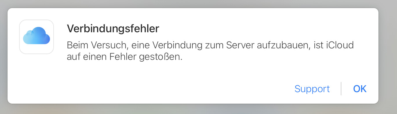

iCloud Binding Communication Error
Looks like the iCloud have some troubles anyhow.
BTW: same, same :frowning:

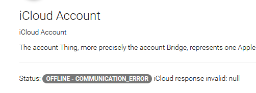

Same here since yeesterday I believe as well on RPi4 8GB running 3.0.2 stable
My iCloud Thing went offline on 2021-05-12 03:00:01.000 and did not become back online yet.
could it be related with OH/rpi favouring ipv6 instead of ipv4 ? my Apple homekit bridge thing got disconnected on that issue…
I think the authentication method changed for this API, but I did not had much more time to look into this.

same issue here:
Just putting my name in the hat so I will see when this is working again… :wink:
same here. 3.0.1 in Docker
