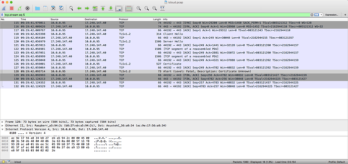

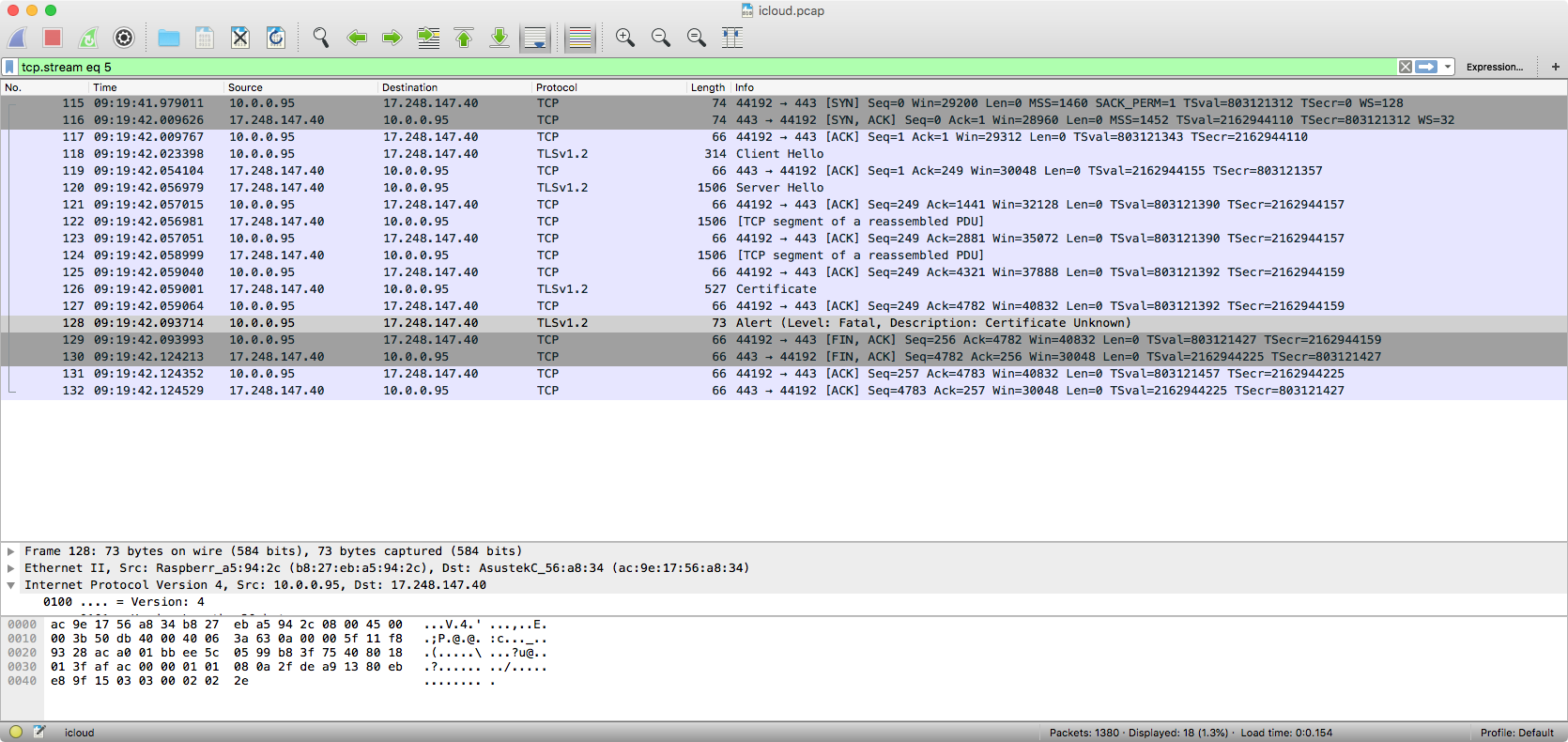

tcpdump:
rename the file to *.pcap
cert_failure.pdf (6.4 KB)
