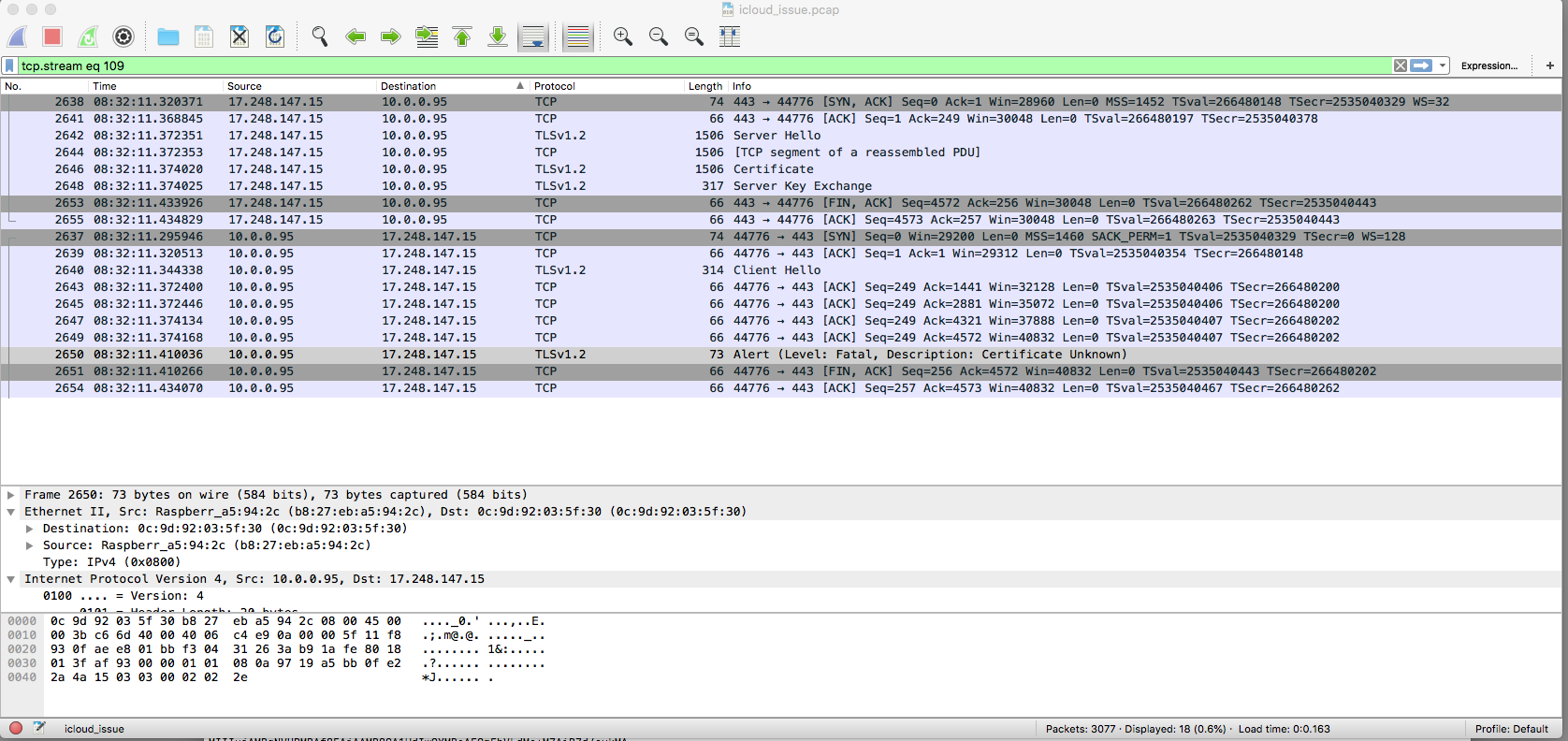

One difference to the issue from last year is that after applying the new certs, both:
pi@openhab : ~/testscripts $ java SSLPoke fmipmobile.icloud.com 443
Successfully connected
pi@openhab : ~/testscripts $ java SSLPoke www.icloud.com 443
are working fine now.

It seems that TLSv1.2 handshake is failing - maybe due to an issue in certificate chain?
icloud_wireshark
